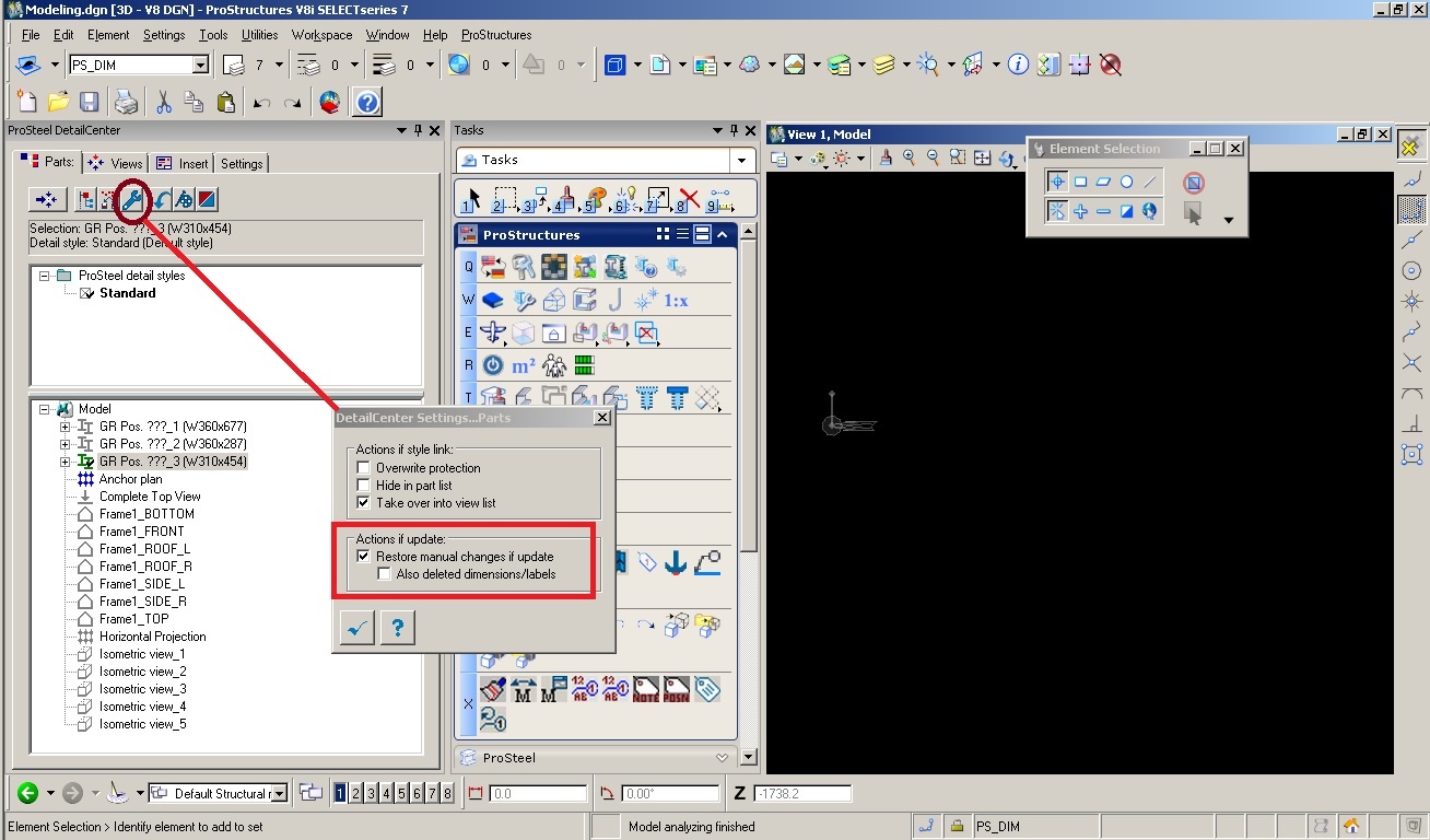

How to update detailing center drawing without affecting the manual changes in 2D drawings? by IronMaxSteel
How to update detailing center drawing without affecting the manual changes in 2D drawings. ( annotation flags, dimension, etc.)
1) Go to detailing center
2) Click special setting
3) Tick the check box under the "action if update"
