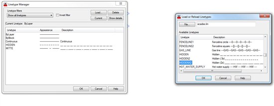

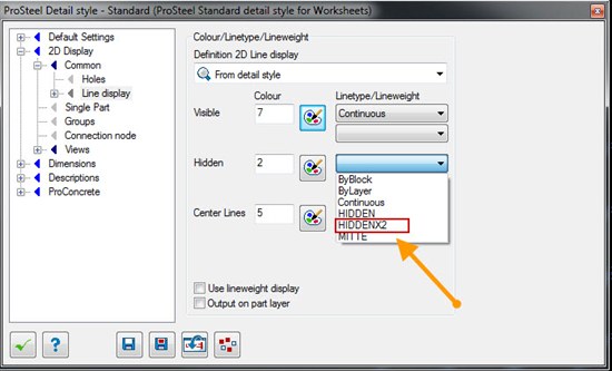

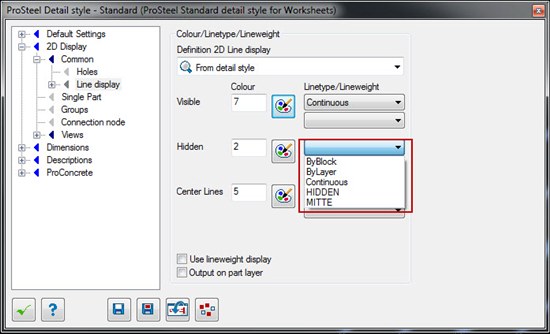

From the Detail Styles there is an option to use the Definition 2D Line display set to From Detail Style. Currently not all the Line types are available from this list.

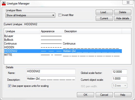

To Add A new Line Style you need to go into the AutoCAD menu Format > Linetype. Then Select the type of line that you want. For this example I am choosing HIDDENX2.
After you save this settings, when you go back into the Detail Style you will now see the newly added Line Type.
