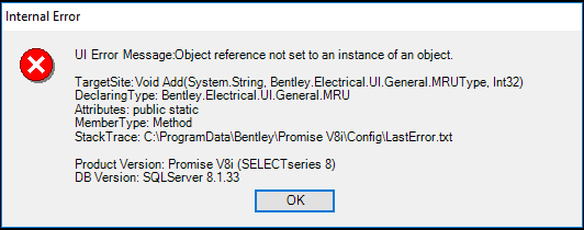

The following error message occurs at startup and project and pages cannot be opened.
Internal Error
UI Error Message: Object reference not set to an instance of an object
TargetSite: Void Add(System.String, Bentley.Electrical.UI.General.MRUType, Int32)
DeclaringType: Bentley.Electrical.UI.General.MRU
Attributes: public static
MemberType: Method
StackTrace: C:\ProgramData\Bentley\Promise V8i\Config\LastError.txt
Product Version: Promise V8i (SELECTseries 8)
DB Version: SQLServer 8.1.33
Explanation:
This error might be occurred because of a sudden shut-down of promis.e or because of some unwanted changes done in the previous session.

Option 1
Reboot the computer on which the software is installed and try again
Option 2
  1. Close the software.
  2. Rename or delete the [[Application Data (per-user configuration) - promis.e|user appdata folder for promis.e]].
