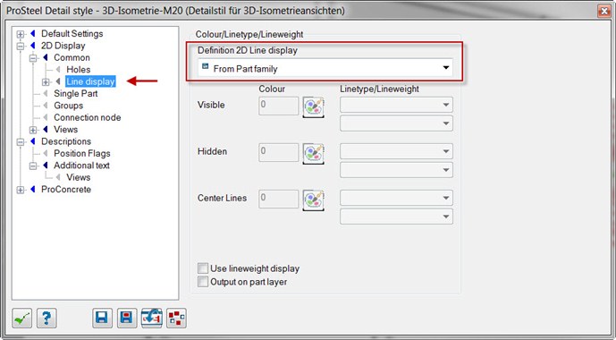

In order to get the preview (from above) you have to edit the detailstyle at:
2D Display/ Common/ Line display "From partfamily"
