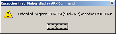

Exception in
at_Dialog_display ARX Command
Unhandled Exception E06D7363 (e06d7363h) at address 7C812FD3h)
Problem Description
This exception message was shown in AutoPlant XM upon trying to load Drawing Preferences or while trying to draw pipe line.  For this particular case issue was related to corrupt specification's MDB file. The steps below could be used for  investigation and resolving  this particular case. However the cause of similar issue could be related to different aspects, others then described here.
