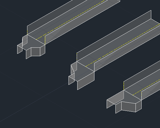

Reducers in Cable Tray module are drawn upside down.

Problem Description
Reducers in Cable Tray module are drawn upside down. Filed as Trouble Report D-125805
Steps to Resolve
Open following files for Straight, Left Hand, Right Hand Reducers - sreducer.ebs, lhredcr.ebs, rhredcr.ebs (C:\Program Files (x86)\Bentley\Plant V8i\Modules\CableT\piping\draw)
Find at_CabCreate_Boundary function that is used to draw Boundaries
Go to ‘\\Create a path to extrude along sections (three are two of them)
Change obj = at_CADLine_create (cpUp, shapePts(7)) to obj = at_CADLine_create (shapePts(7), cpUp) in one section and
obj = at_CADLine_create (cpUp, shapePts(6)) line to obj = at_CADLine_create (shapePts(6), cpUp) in another section
