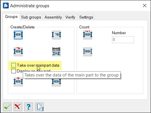

When the groups are created manually with the help of create group command, and after that the group properties of sub part shows the name of the main part instead of its own.
Some users may get confused because of this name display of the main part showing for the subpart. This happens because there is one setting that is checked while creating the groups. In this wiki,  we will learn where this setting is and how we can control it.

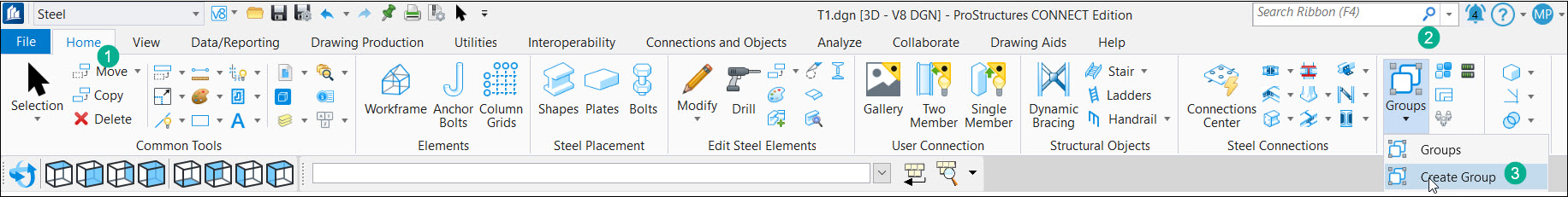

1. To avoid the display of the main part name in the group properties of the subpart, you need to first navigate to the create group command located under Home>classification>create a group.
2. Now, here, before creating a group, you need to uncheck the option ‘Take over main part data’.
3. This will not show any name in the name field of the subpart once group properties are viewed.
In this way, one can disable the name display of the main part in group properties of subparts to avoid confusion.
