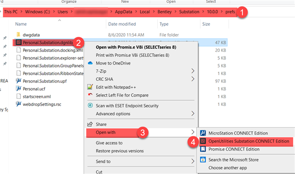

1. Go to the location “C:\Users\(Current User)\AppData\Local\Bentley\Substation\10.0.0\prefs” and then open the Personal.Substation.dgnlib file with Substation

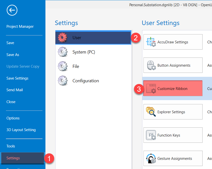

2. Next go to File  Setting  >> User >> Customize Ribbon

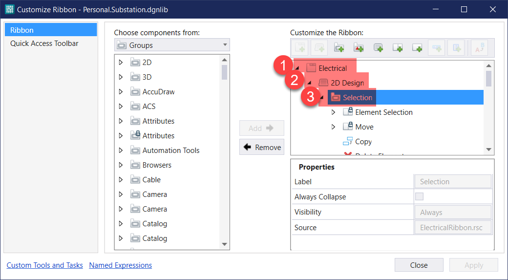

3. Next in the Customize Ribbon dialog go the Customize the Ribbon section and then select the Workflow  (e.g. Electrical ) >> Ribbon (e.g. 2D Design) >> Group (e.g. Selection) according to user requirement where the icon needs to be created.

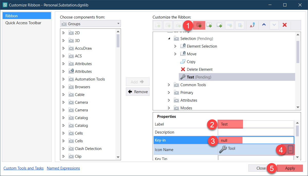

4. Next select the New Button Dialog, then add the Label for the Icon, next specify the command in the Key-in which needs to be executed when the icon is clicked. Then select the Icon according to your requirement and click Apply.
5. Next once the changes are done go to File  >> Click Save Settings.  Now Promis.e can be launched normally to use the Icon.
