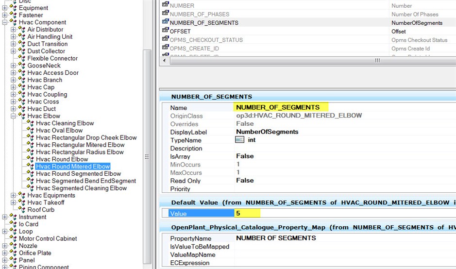

  1. Open class editor and load OpenPlant_3D schema.
  2. Supplement OpenPlant_3D_Supplemental_Modeling and OpenPlant_3D_Supplemental_Metric_DefaultValues with it.

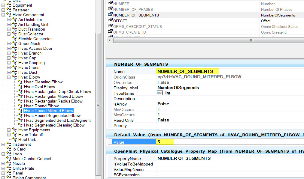

  3. Go to HVAC_ROUND_MITERED_ELBOW class and select Number of Segments property.
  4. Change the value field in Default Value custom attribute as highlighted above and save the changes.

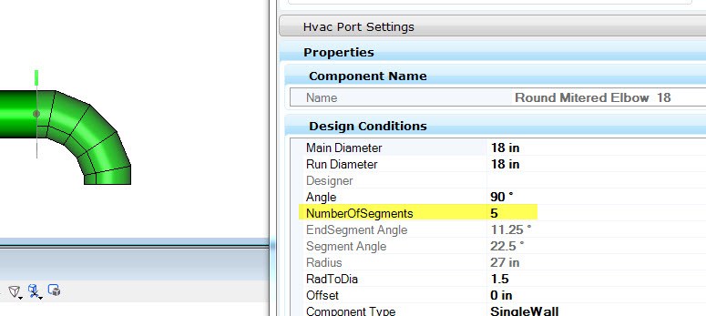

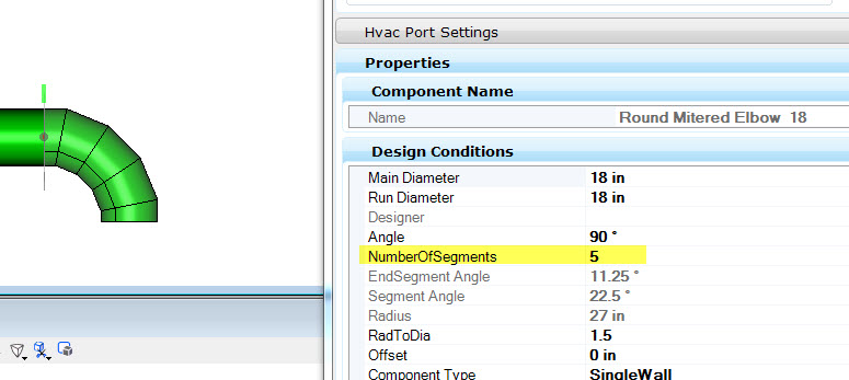

  5. Verify the result in OPM.
