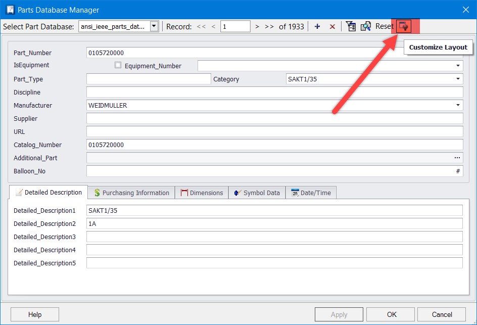

1. Launch Promis.e CONNECT on which the Parts Database Manager dialog has been customized, Then open Parts Database Manager from Electrical >> Manage >> Parts Database under Catalogs.
2. Next Click on Customize Layout option in the Parts Database Manager dialog.

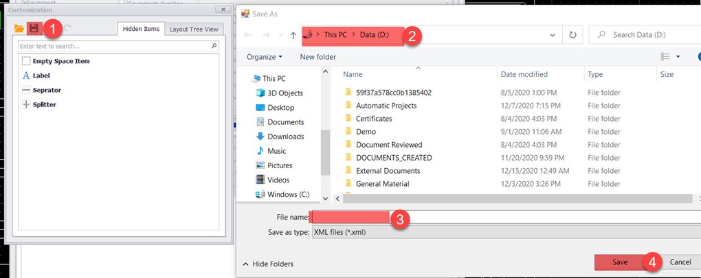

3. Next in the resulting Customization Dialog select Save Layout option, then select the location where the file with Customization needs to be save and select Save.
4. Now the .XML file created needs to be shared with other users to whom the customization needs to be deployed.

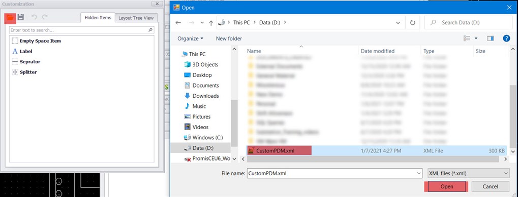

5. On the machine where the customization needs to be deployed follow the above Step1 & 2 to open the Customize Layout Dialog.
6. Next in Customize Dialog select Load Layout, the browse to the location where the .XML file deployed is saved and select Open to Load the customization.
