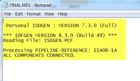

While running Iso through Isogen following error is observed when third party software like PDMS install on the machine.
Iso.--Personal Isogen Error 13
Message file shows following error.
Steps to Resolve
There is an environment variable called ‘PDMSWK’ which gets created when we install PDMS.
Delete this environment variable. Iso is extracted correctly.
This variable gives the same isogen error 13 in PDS & SP3D when they are installed on a machine having PDMS.
