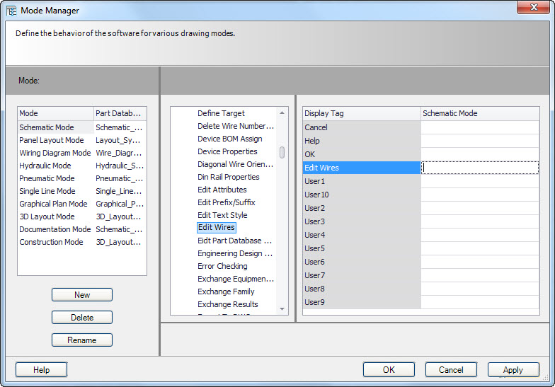

  1. Open Mode Manager.
  2. Click on the > icon beside Promis.e or Substation Connect Edition in the center column. The display will expand to show all the dialogs for the selected drawing mode
  3. Click on the name of the dialog to edit. The field labels, button labels and prompts for that dialog will be listed on the right side of the dialog. For example, select "Edit Wires".

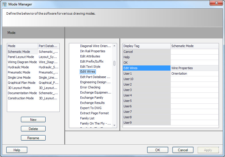

  4. To edit a label, enter the new label text in the Mode field on the right. For example, enter "Wire Properties" next to "Edit Wires" and enter "Orientation" next to "User1".
  5. Select Apply or OK to save your changes.

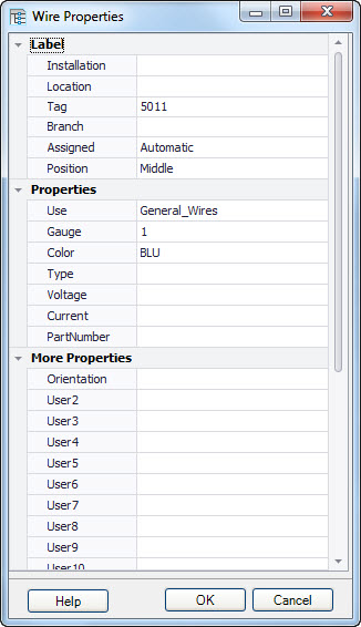

After applying the above changes the Edit Wires dialog appears as follows.
