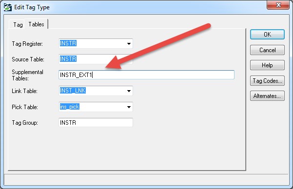

Editing the project tag types to use the new INSTR_EXT1 table
Now that the new table is defined you need to assign it to the required tag types as a Supplemental Table. This is performed in the Project Administrator. This process applies to all database types.
- Load the Bentley Project Administrator.
- Expand your project name node then the Database node and pick on the Tag Types node.

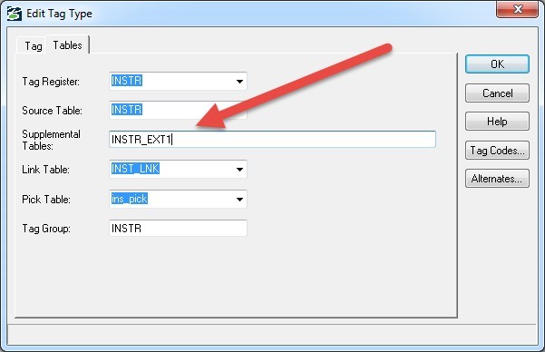

- Locate the AT_CVALVE tag type. Double click the tag type or pick the Edit… button.
- In the Edit Tag Type dialog pick the Tables tab.
- In the Tables tab and in the Supplemental Tables: field, add the new INSTR_EXT1 table as shown below.
- Pick OK.
- Repeat this process for all instrument tag types. AT_INST_, AT_INST_CS, AT_INST_FLO, AT_INST_MCC and AT_INST_ORF.

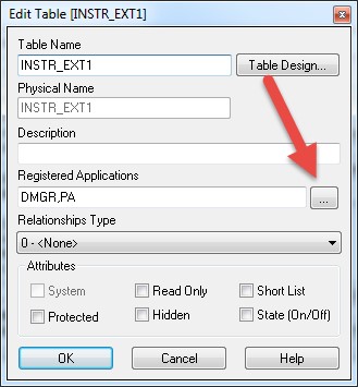

- Select the newly created INSTR_EXT1 table. Pick EDIT.

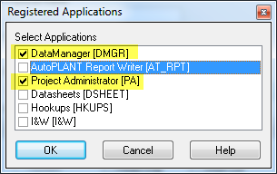

- In the Edit Table [INSTR_EXT1] dialog the pick the ellipse button next to the Registered Applications field.
7. As a minimum check on DataManager [DMGR] and Project Administrator [PA]. Others can be selected as well based on the need for this table in those applications. Pick OK.
8. Pick OK in the Edit Table [INSTR_EXT1] dialog box.

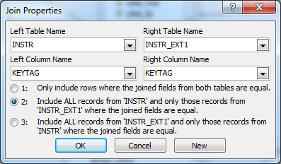

- A join line will be created between the newly added INSTR_EXT1 table and the KEY_LINK table. Right click on this join line and from the context menu pick Delete.
- Create a new join between the INSTR_EXT1 table and the INSTR table by clicking on the KEYTAG field in the INSTR table and dragging this over and dropping it on the KEYTAG field on the INSTR_EXT1 table.
- Right click on the join line and pick Join Properties.
- In the Join Properties dialog set the left and right tables and the left and right columns as shown below. Also set the join type to the second join type identified with the number 2 by picking the radio button next to the number 2.
11. Pick OK.

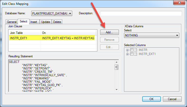

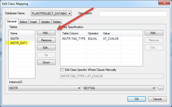

- Locate the Control Valve class. In the Class Mapping tab select the Edit… button in order to edit the mapping for Control Valves.
- When the Edit Class Mapping dialog loads start with the General tab. Add the new table to the Tables list by using the Add… button. Add the INSTR_EXT1 table. See below.

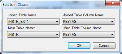

11. Move to the Select tab. You must now add the Join Table clause. Pick the Add… button and in the Edit Join Clause dialog set the Joined Table Name to INSTR_EXT1 and the Main Table Name to INSTR Set both column names to KEYTAG. See below.
12. Pick the OK button.

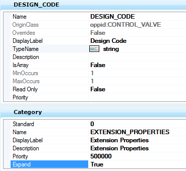

Adding new properties to Control Valve class
Now that the database table has been defined and the mapping between the Control Valve class and the new tables complete you will add properties to the Control Valve class into which you can add the additional data.
- Continuing in the Bentley Class Editor.
- Right click on the OpenPlant_PID schema and from context menu select Supplement Schema…
- Add the OpenPlant_PID_Supplemental_Imperial schema.
- Browse to the Control Valve class. Switch to the Properties tab.
- Add the four new properties that are to be written into the INSTR_EXT1 table. Add all of these properties to a new Category Named EXTENSION_PROPERTIES. See below. The Property name will change but the Category Custom Attribute will be the same for all four properties. Add DESIGN_CODE, BODY_STYLE, ACTUATOR_STYLE and POSITIONER_REQUIRED.
6. Save the schema.

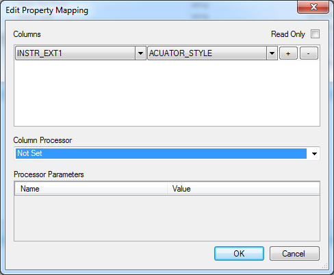

- Locate the ACUATOR_STYLE property. In the Class Mapping tab, lower panel select the Edit… button.
- In the Edit Property Mapping dialog add the mapping to the new table and field. Pick the INSTR_EXT1 table and the ACTUATOR_STYLE field.
10. Pick OK.
11. Repeat this process for the three remaining new properties mapping them to their respective field in the new table.
