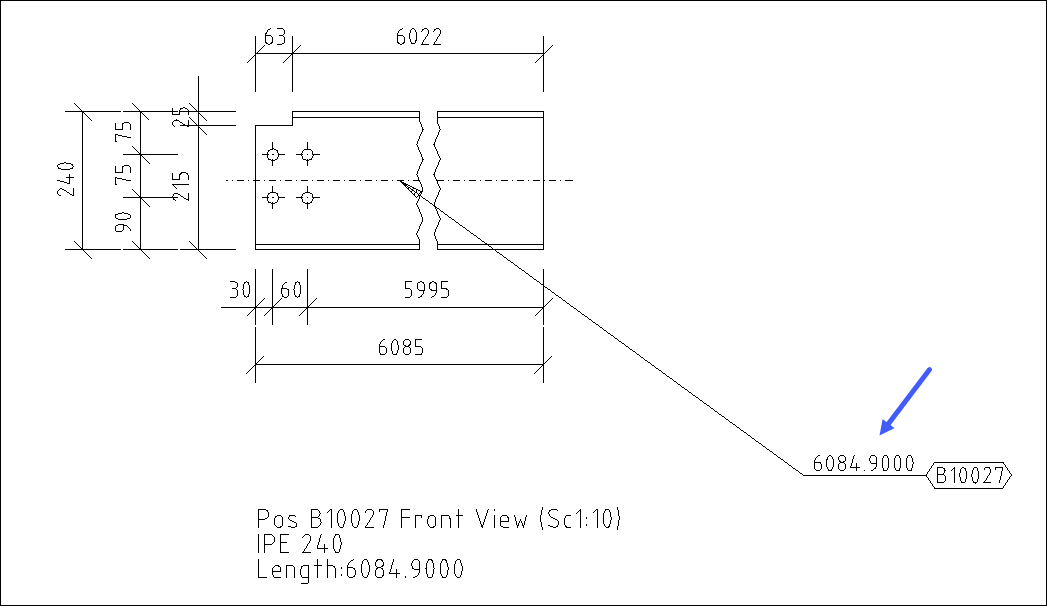

When the position flags are inserted in the drawing, sometimes users may face issues where values in the position flags can be seen in multiple decimals.
This happens due to the unit accuracy set in the dimension style. In this wiki, we will learn how to resolve this issue.

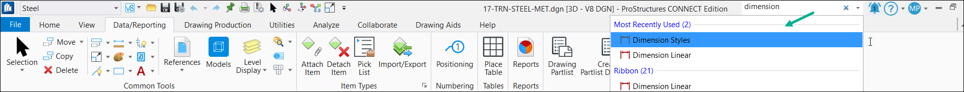

1. First, check the dimension style which is used in the drawing and then search ‘Dimension Styles’ in the search ribbon

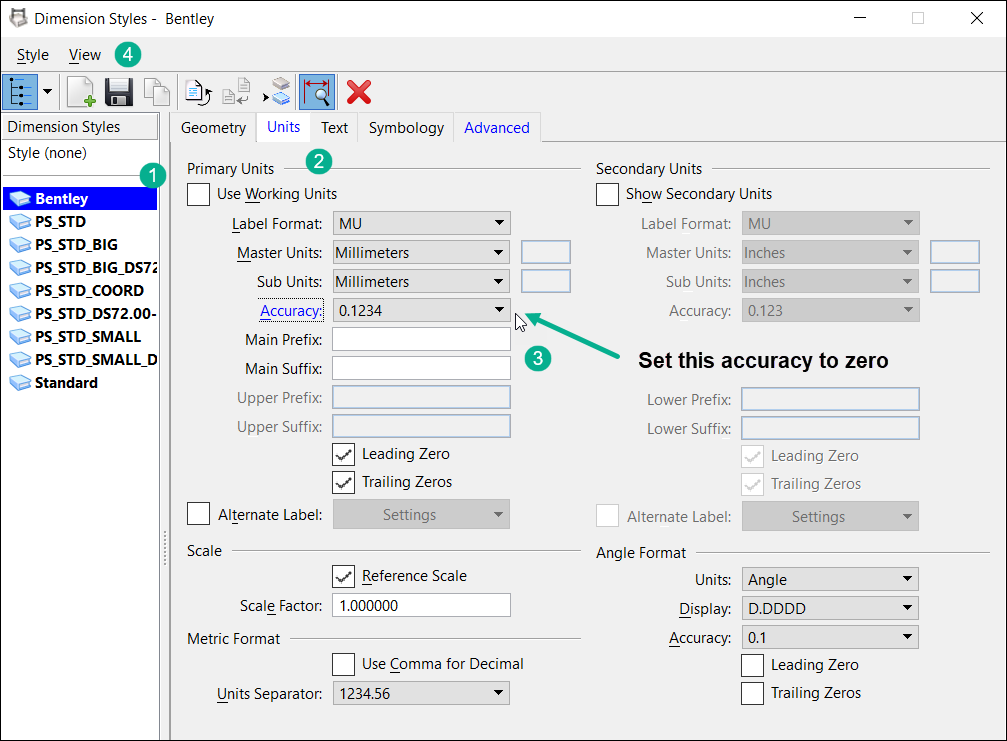

2. Now, click on the dimension style, which is active in the drawing, and under that, click on the units tab.
3. Here set the unit accuracy to zero i.e., none, and save the dimension style
4. Now, regenerate the drawings and you will observe the extra decimals of the values on the position flag text is removed.
