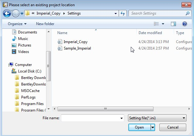

It is often required to transfer the project between users/clients for project and work sharing. OpenPLANT Orthographics can Import current project to generate Orthographic drawings from the 3D model. This Wiki shows how to import existing project in OpenPLANT Orthographics manager
1. Click the Import Existing Project icon in the Bentley OpenPLANT Orthographics manager window.
2. A dialog prompt will appear prompting for the settings.ini file. The %Project%.ini file is located in the Settings directory as shown in the image below
3. Once the settings.ini file is selected. Click Open to start importing the Project.
4. The project will get listed in the available project list and will allow users to further configure/generate drawings, etc.
