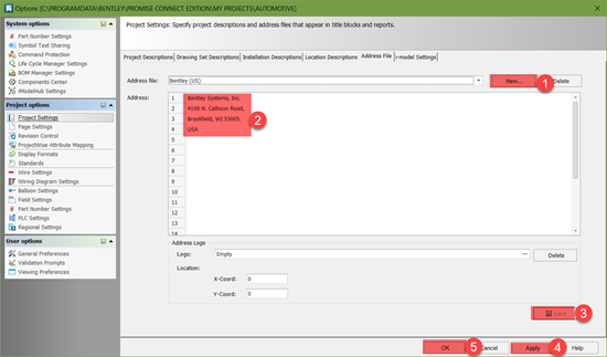

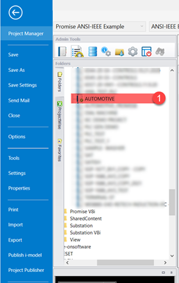

1. Open Project Manager in Promis.e CE and select the Projects for which the Company Name & Address need to be changed.

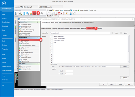

2. Select Options in Admin Tools, in the Options dialog select Project Settings >> Address File.
3. In the Address section you can modify the existing Address with new details to change the details in Project, also you can create new Address File by clicking New specify name. This new Address File will save the details to be later used in other projects. To save the changes select Save and then select Apply >> OK

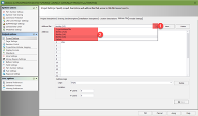

4. In new Projects to select the existing Address follow the above Step 1 & 2, next Select the Address File Drop down list to select the required Address.
