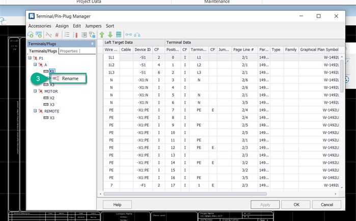

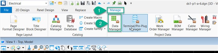

  1. Open Terminal/Pin-Plug Manager.

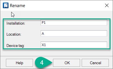

  2. Right-click the name of the strip or plug and select "Rename".
  3. Rename the Installation, Location, or Device tag as desired.

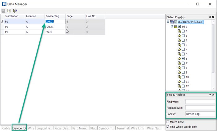

  1. Open [[Data Manager]].
  2. Select the Device ID tab.  The results can be filtered by clicking the filter symbol in the upper right of any column header.
  3. Change the Installation, Location, or Device tag values as desired.  If multiple rows are selected, a change to one row will propagate to the other selected rows.  The Find & Replace pane can also be used.

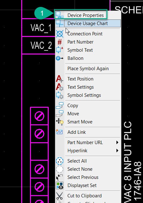

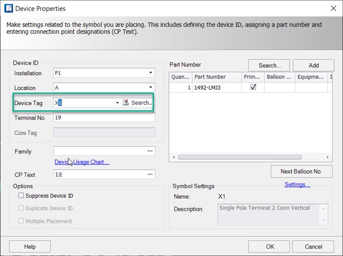

  1. Right-click a schematic symbol for a terminal in the terminal strip to be renamed, select Device ID.
  2. Change the Installation, Location, or Device tag values as desired, click OK
  3. Choose the desired option from the dialog that appears:
    - Update all terminals found vertically in line with this terminal
    - Update all terminals in project
    - Do not update any other terminals
