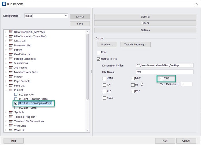

  1. Open a page in the project from which the data is to be exported.
  2. Select the Run Reports tool.
  3. On the Run Reports dialog, expand the PLC List category.
  4. Preview the various templates in the PLC List category to find the most appropriate one.
  5. Set the check box next to the chosen template.
  6. Set the Output To File check box.
  7. Specify a Destination Folder and a File Name with no file extension.
  8. Set the CSV check box. The CSV format can be opened in Excel and typically has a "cleaner" output whereas the XLS format may have extra rows and columns to preserve WYSIWYG.
  9. Click the Run button.
