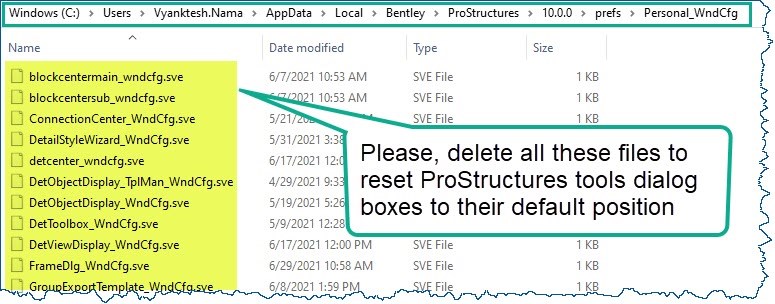

When opening any tool in the ProStructures application the dialog boxes do not appear at all or appear way bigger than usual.
Reason

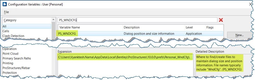

If you are using multiple screens and closed any ProStructures dialogs on another screen instead of the main screen then those dialogs position gets fixed at that screen location which stores in *_WndCfg.sve file and when you use only a single main screen then those dialogs do not appear. These *_WndCfg.sve file are located at where the PS_WNDCFG config variable is defined.
The solution to this problem is to delete all *_WndCfg.sve files that will reset all dialogs to their default position. It´s mostly needed to delete these files when you switch monitors or resolution.
Steps to resolve
There are three ways to fix this issue, please follow the one which suits you.
Method-I: Manually Deleting *_WndCfg.sve files
1. If ProStructures is running then, please close the application.
2. Go to the below path which is defined by the config variable PS_WNDCFG and delete all *_WndCfg.sve files.
Path: DriveName:\Users\<User Name>\AppData\Local\Bentley\ProStructures\10.0.0\prefs\Personal_WndCfg
3. Launch the ProStructures and check your tool dialog which should appear now at default location.

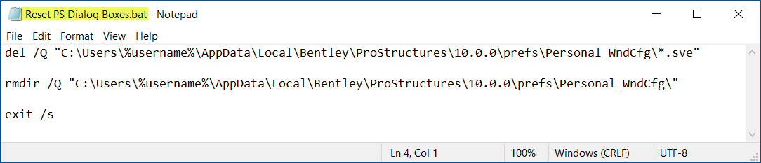

1. Create a text file, give a required name and change the extension to *.bat (e.g., Reset PS Dialog Boxes.bat).
2. If you have not customized the config variable PS_WNDCFG then copy the below command lines and paste it in the text file (or you can directly download the batch script file from Here).
The command lines with default path will be as follows-
del /Q "C:\Users\%username%\AppData\Local\Bentley\ProStructures\10.0.0\prefs\Personal_WndCfg\*.sve"
rmdir /Q "C:\Users\%username%\AppData\Local\Bentley\ProStructures\10.0.0\prefs\Personal_WndCfg\"
exit /s

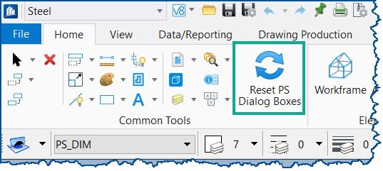

Method-IV: Creating Reset button within the ProStructures
Example i: Deleting *_WndCfg.sve files from the default location (...\ProStructures\10.0.0\prefs\Personal_WndCfg\ folder)

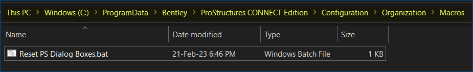

1. Download the below script file which has the command lines explained in Method-III.
Download the Script File: Batch Script file to reset ProStructures dialog boxes - Example i.
2. Place it in the required location. e.g. C:\ProgramData\Bentley\ProStructures CONNECT Edition\Configuration\Organization\Macros

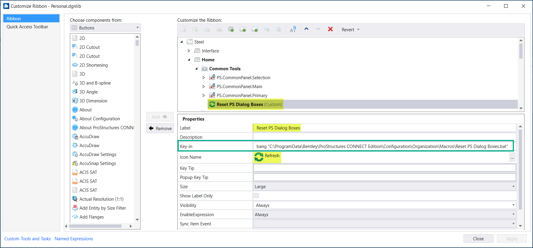

3. Open the Customize Ribbon dialog, create a new button and fill the required options and under the Key-in field set the key-in as follows-
bang "C:\ProgramData\Bentley\ProStructures CONNECT Edition\Configuration\Organization\Macros\Reset PS Dialog Boxes.bat"
4. Now, you are all set to use the Reset PS Dialog Boxes button to reset ProStructures dialog boxes to its default position.

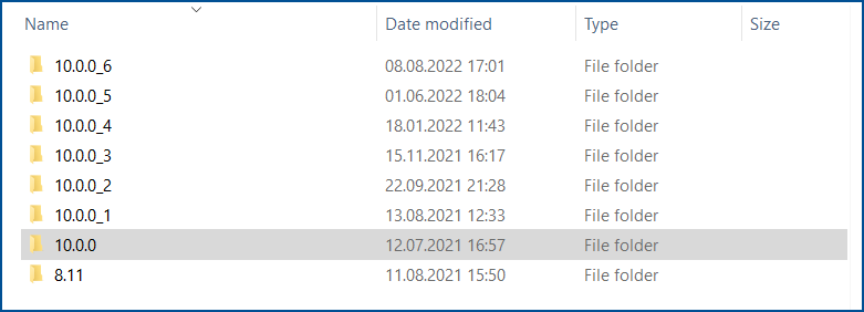

Example ii: Deleting *_WndCfg.sve files from the multiple versions of the User Preference folders (e.g. 10.0.0.x) as shown in the below image
1. Download the below script file which has the command lines as follows.
del /Q /S "C:\Users\%username%\AppData\Local\Bentley\ProStructures\*WndCfg.sve"
rmdir /Q "C:\Users\%username%\AppData\Local\Bentley\ProStructures\"
exit /s
Download the Script File: Batch Script file to reset ProStructures dialog boxes - Example ii.
2. Now, follow the Steps 2 to 4 from the Method-IV > Example i of this wiki.
