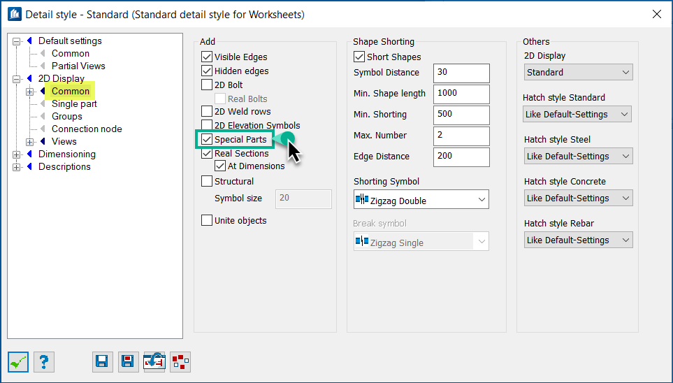

1. Open Detail Center, go to the Settings tab and enable Scan Composite Model.
2. Also make sure to enable Special Parts in the Detail Style > 2D Display > Common if you have any non ProSteel objects in the referenced file.
With this you will now get the objects in the 2D drawing of Detail Center.
