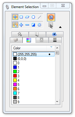

A quick way to change many individual elements of color 255,255,255 in a drawing to color 0 is with the following process.  If the elements are part of a symbol or title block, etc., modify those items then update the project with the revised items.  Step 1 can also be used just to confirm the problem is that the elements are set to color 255,255,255.
  1. Expand the Element Selection box and select the color tab, then select color (255,255,255). This selects all elements of that color in the design file.
  2. Select Electrical ->2D Design-> Common tool -> Change Element Attributes
  3. Place a check in the box for all properties to change. In this case, check only "Color" and set Color to 0.
  4. Left click on the drawing to Accept (to apply the settings).
