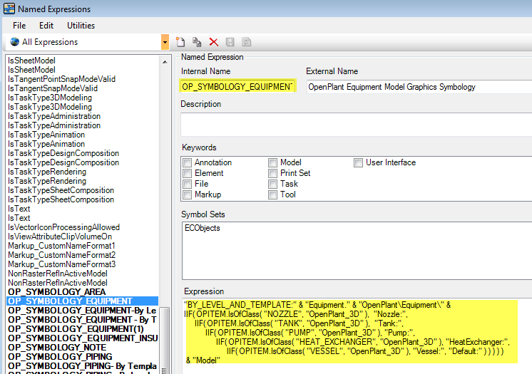

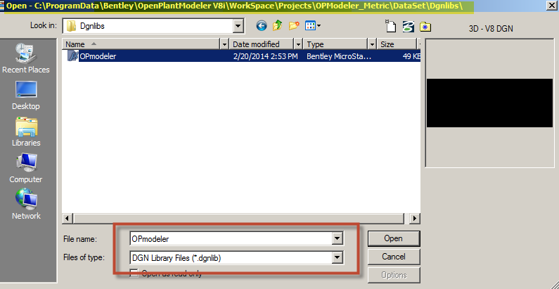

  1. Go to File from Main Menu option and open DGN library files (dgnlib). See image below :
  2. Under Utility Menu, Select Named expression and click on OP_SYMBOLOGY_EQUIPMENT. See image below for reference.
  3. Below are the Symbology pasted to copy from here and to get it pasted to its respective Expression’s.
    OP_SYMBOLOGY_EQUIPMENT:
    "BY_LEVEL_AND_TEMPLATE:" & IIF(OPITEM.IsOfClass("NOZZLE", "OpenPlant_3D"), "Nozzle:",
     IIF(OPITEM.IsOfClass("TANK", "OpenPlant_3D"), "Tank:",
         IIF(OPITEM.IsOfClass("PUMP", "OpenPlant_3D"), "Pump:",
             IIF(OPITEM.IsOfClass("HEAT_EXCHANGER", "OpenPlant_3D"), "HeatExchanger:",
                 IIF(OPITEM.IsOfClass("VESSEL", "OpenPlant_3D"), "Vessel:", "Equipment:"))))) & "OpenPlant\Equipment\" &
      IIF( OPITEM.IsOfClass( "NOZZLE", "OpenPlant_3D" ),  "Nozzle:",
         IIF( OPITEM.IsOfClass( "TANK", "OpenPlant_3D" ),  "Tank:",
              IIF( OPITEM.IsOfClass( "PUMP", "OpenPlant_3D" ), "Pump:",
                   IIF( OPITEM.IsOfClass( "HEAT_EXCHANGER", "OpenPlant_3D" ), "HeatExchanger:",
                        IIF( OPITEM.IsOfClass( "VESSEL", "OpenPlant_3D" ), "Vessel:", "Default:" ) ) ) ) ) & "Model"

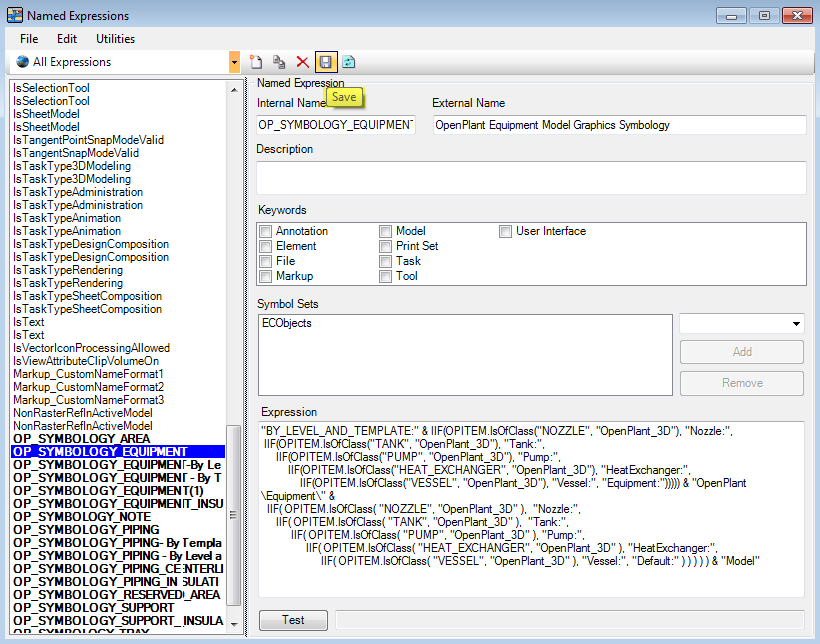

  4. Save each Expression which turns blue. Save option will get enabled once you modify the Expressions: See below for reference.

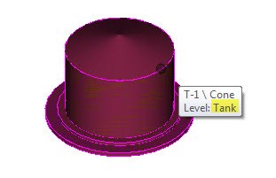

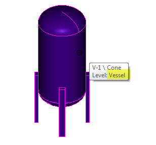

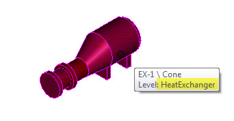

  5. Launch OpenPlant Modeler and Verify results. See images below:
    Equipment Level as ‘Vessel’
    Equipment Level as ‘Tank’

    Equipment Level as ‘Heat Exchanger’
