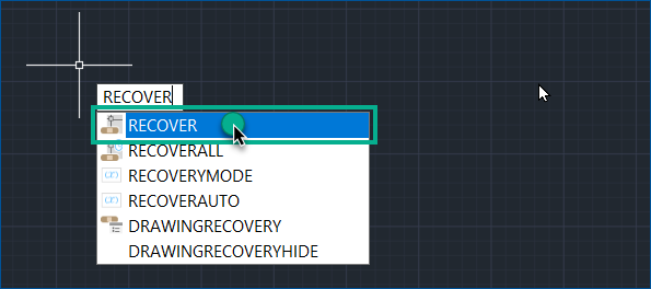

2. Type Recover and hit Enter key.

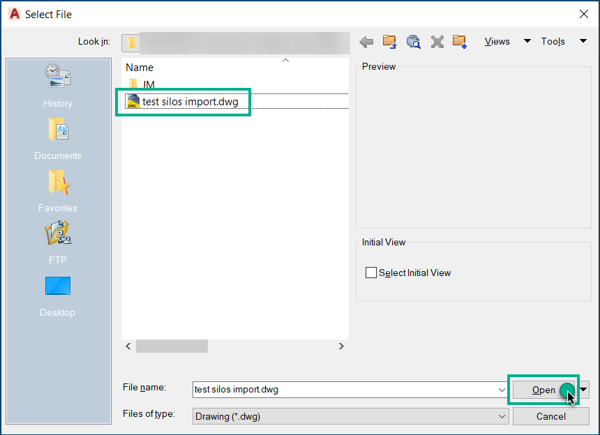

3. Select the file which you want to recover and click on the Open button.

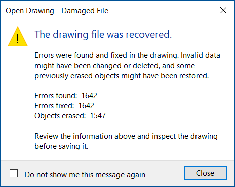

4. It will take some time to recover the file and once recovered the below dialog pops up with some data.

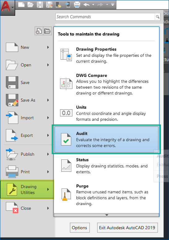

5. Now run the audit to correct some errors if exists from the Drawing Utilities > Audit.

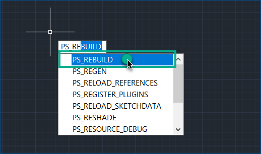

6. Use the option 6 from the PS_REBUILD command to remove Modeler errors parts from the model.
