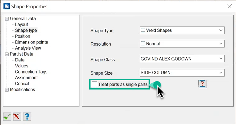

Groups getting dissolved on positioning the Welded Shapes
 Product(s):ProSteel
 Area:General
 Subarea:Grouping
Problem Description
The grouping is getting dissolved for welded shapes when positioning.
Steps to resolve
Enter methods to resolve in this section.
1. Open the Structural Properties of the Welded Shapes.
2. Go to the General Data > Shape Type and turn off the 'Treat parts as single parts’.
3. Now, re-group the objects and then re-position them, this time groups will not dissolve.
