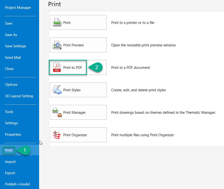

  1. Select the pages to print in [[Project Manager]].
  2. In Project Manager, select Print to PDF. This will send the DGN files for the pages to Print Organizer.

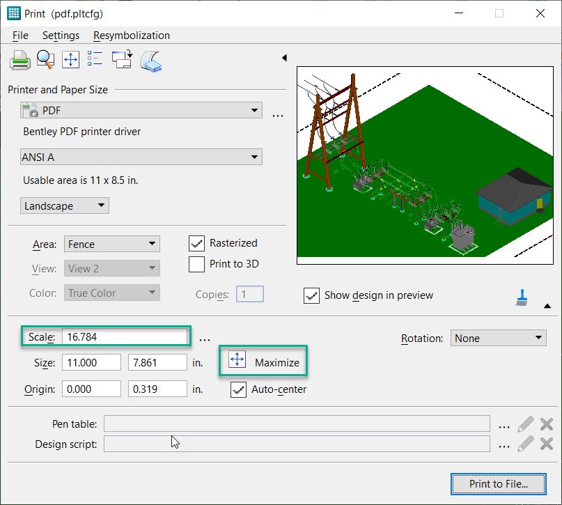

  3. Right-click a DGN file in Print Organizer and select Properties.
    Note that multiple DGN files can be selected, the selection set right-clicked, and Properties selected. This will make any changes to the Properties affect all the DGN files in the selection set.
  4. Set the settings as desired, then click OK. Some settings of interest:
    On the Main tab, select the desired paper size. Then click the Maximize button to fit the drawing to the paper size. The Maximize button looks like a cross-hair.
    On the Advanced tab, set Color to "Monochrome" if desired.
  5. In Print Organizer select Printer Setup and select the pdf.pltcfg file for the driver File Name, click OK.
  6. In Print Organizer select Print. Select "Single print job" for Submit As if multiple pages are being printed and they should be printed to a single PDF file. Specify the desired path and filename in the Destination field, click OK.

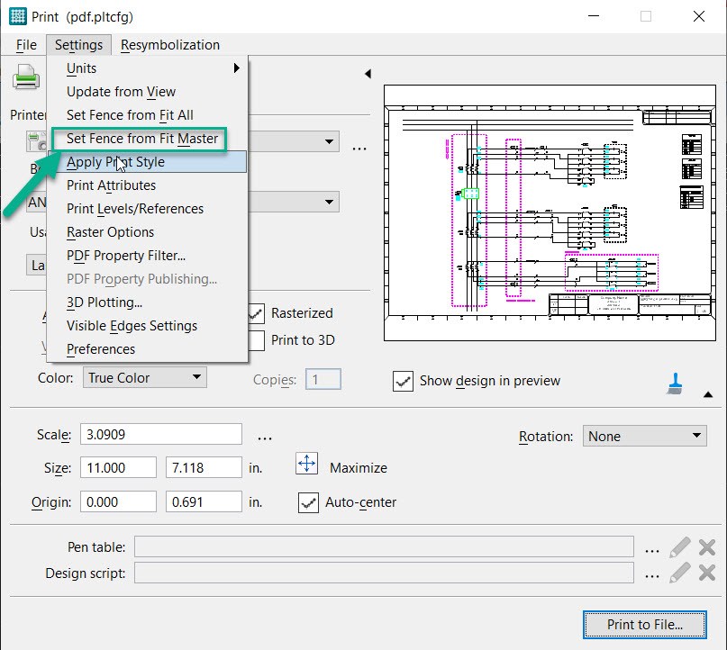

    Note:- To make it Fit view, Select the below setting,
[[Project Publisher - create PDF files of your projects]]
