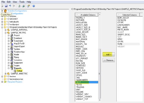

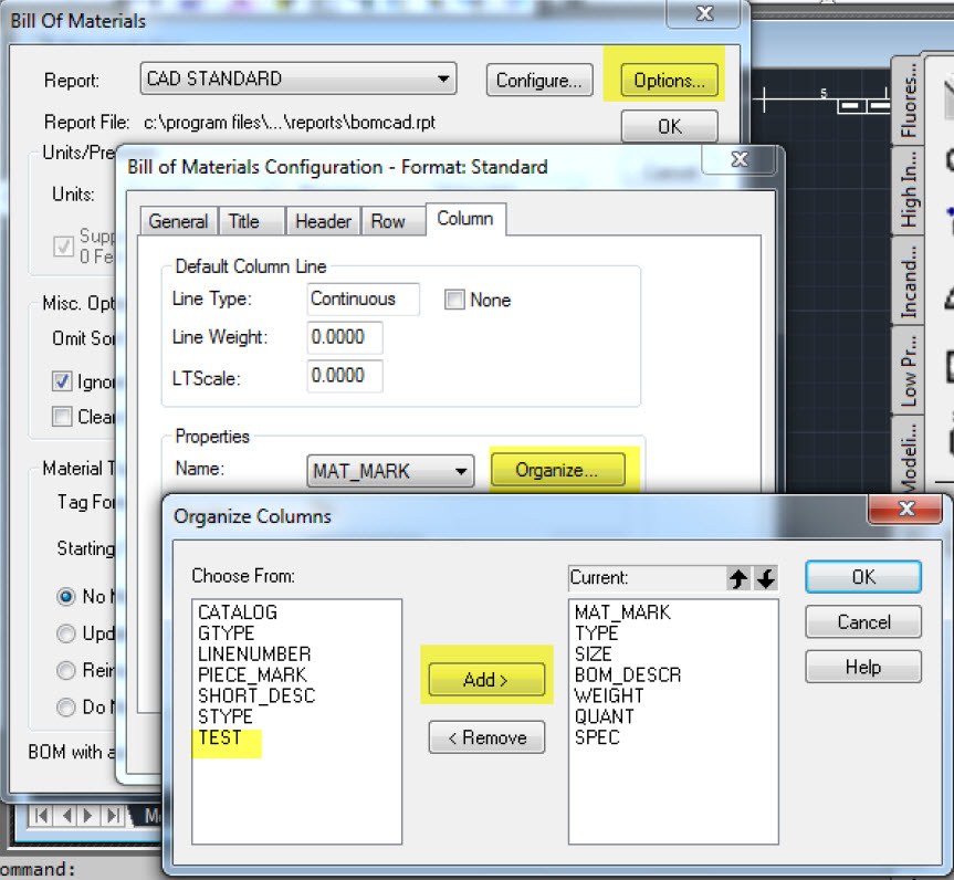

At times, user may want to add an additional field to isometric bill of material (i.e. Part Number, Vendor Catalog data etc.).following steps illustrate the procedures to add catalog field in isometric bill of material.
Refer following link
communities.bentley.com/.../4207.adding-a-new-descriptive-field-to-updateable-component-data-tn
