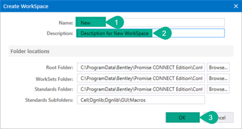

A. Creating a new WorkSpace & WorkSet using Promis.e application

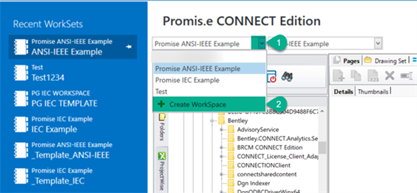

1. Launch Promis.e and go to Project Manager.
2. Next Click on the WorkSpace dropdown and select Create WorkSpace.
3. Next in Create WorkSpace dialog specify the Name & description for the WorkSpace and select Ok.

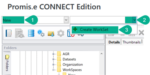

4. To Create WorkSet select the WorkSpace from Step 3, then select the drop down for WorkSet and select Create WorkSet.
5. After the WorkSpace and WorkSet are created the OOTB or Custom Configuration files need to be added to the file structure using Windows Explorer.

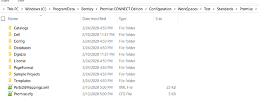

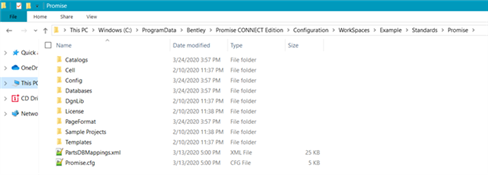

6. Using Windows Explorer go the location of any OOTB Workspace’s Standard folder according to user requirement.
For Promise ANSI-IEEE ExampleC:\ProgramData\Bentley\Promise CONNECT Edition\Configuration\WorkSpaces\Promise ANSI-IEEE Example\Standards
For Promise IEC Example C:\ProgramData\Bentley\Promise CONNECT Edition\Configuration\WorkSpaces\Promise IEC Example\Standards”
7. Browsing to any one of the above location copy the Promise folder and paste in the new WorkSpace folder location “C:\ProgramData\Bentley\Promise CONNECT Edition\Configuration\WorkSpaces\New\Standards”.
8. The dataset in can be kept as it is with OOTB configuration or can be replaced with custom Promis.e Configuration Dataset files.

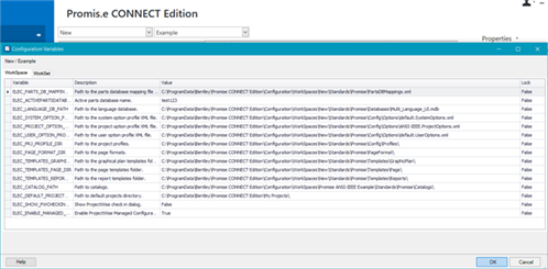

11. Launch Promis.e and go to Configuration Variables and check if everything is configured with new WorkSpace folders.

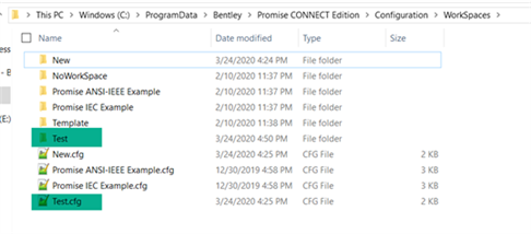

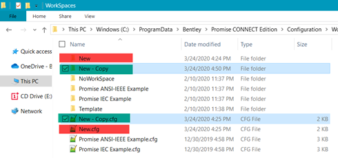

1. Copy & Paste existing WorkSpace folder & WorkSpace.cfg file in the location “C:\ProgramData\Bentley\Promise CONNECT Edition\Configuration\WorkSpaces”.
2. Next rename the WorkSpace folder & WorkSpace.cfg file to New WorkSpace name according to requirements.
3. Next browse to the WorkSet folder and rename the files according to the requirement to reflect the new name for WorkSet. Location “C:\ProgramData\Bentley\Promise CONNECT Edition\Configuration\WorkSpaces\Test\WorkSets”
4. Once the new WorkSpace & WorkSet have been created user can replace the existing files with new or older / custom Promis.e Configuration Dataset files.

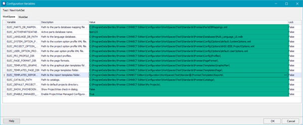

5. Launch Promis.e and go to the Configuration Variables. Make the changes to the Path for dataset file’s in WorkSpace & WorkSet configuration. For details on the Configuration variables you can refer the below Wiki link.
communities.bentley.com/.../configuration-variables---promis-e
Project Manager >> Configuration Variables
