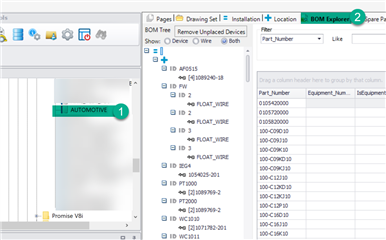

  1. Select the Project where unplaced devices are present and then select BOM Explorer tab of Project Manager. Tabs are along the Top of Project Manager.
  2. In BOM Tree Devices in the project that have no symbols inserted should appear with the ID icon in a darker/bold color and the device tag may be surrounded by brackets. Right-click such device tags and select Remove.

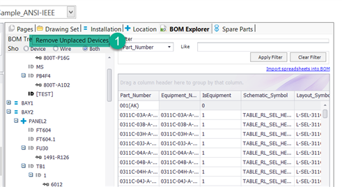

Remove all unplaced devices
The Remove Unplaced Devices button removes all devices that have no associated symbols placed in the project.
  2. To remove all the Unplaced Devices select the Remove Unplaced Devices button is near the top of the BOM Tree pane.
