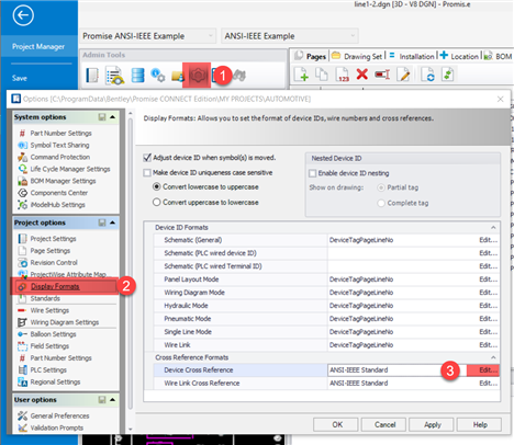

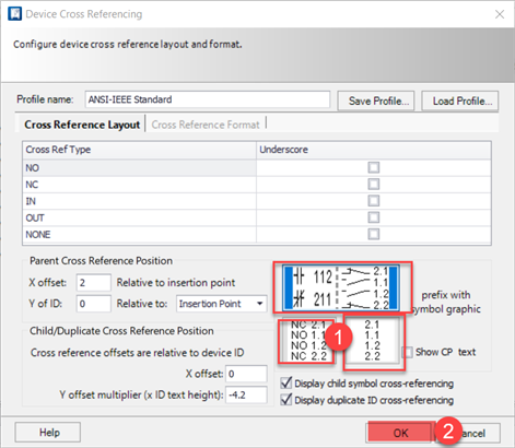

Users might need to change how a Cross-Reference Prefix Appearance depending upon the requirement. There are 3 types of Cross Reference as below
1. Cross Reference with Symbol Graphics Prefix.
2. Cross Reference with Symbols Type Prefix.
3. Cross Reference with No Prefix.
1. Open any Project Page of the Project where you need the changes to be made.
2. Goto Project Manager by selecting File >> Options >> Display Formats >> Device Cross Reference.
3. In the Device Cross-Reference dialog select the Cross-Reference Layout according to the project requirement from Symbol Graphics PrefixSymbols Type Prefix, or No Prefix, and then select Ok on all the dialogs to save the settings.
