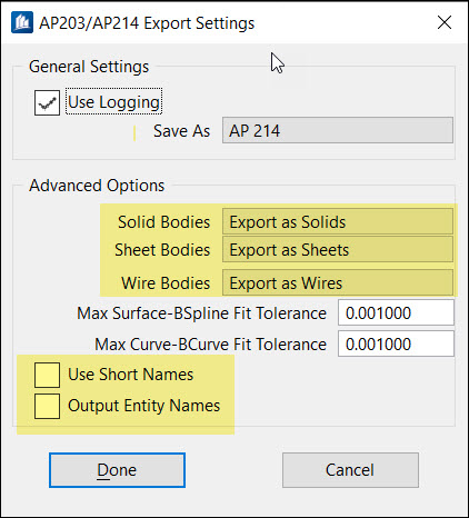

1. First, select the model and elements which you want to include in the export.
2. Now, navigate to the backstage File>Export>ExchangeFileTypes>STEP
3. This will open the STEP export dialog and underneath it you can select the output file path and assign author, and organization.
4. Under the settings dialog, you can change the different export settings for elements display and their properties.
5. Once done, click on export and this will create .stp file at the provided output path.
In this way, with such easy steps, one can export to a STEP file.
