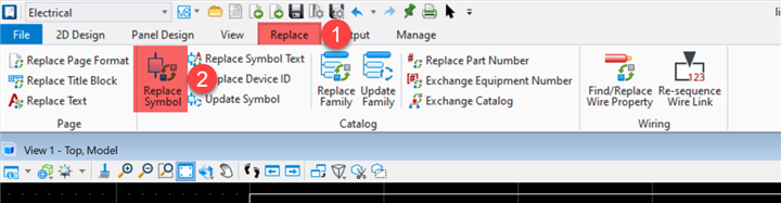

1. Open any Project Page in Promis.e CONNECT and go to Replace >> select Replace Symbol.

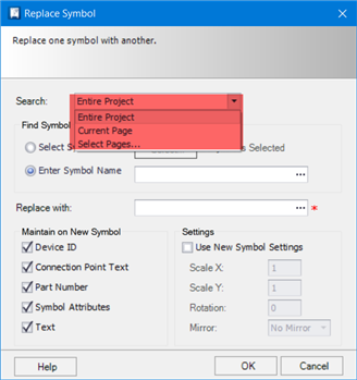

2. In Replace Symbol dialog select Search for the symbols if you need to replace symbols in a specific Page or Current Page or entire Project.
Note: This step needs to be skipped to Step 4 if a specifically selected symbol/s in a page needs to be replaced.

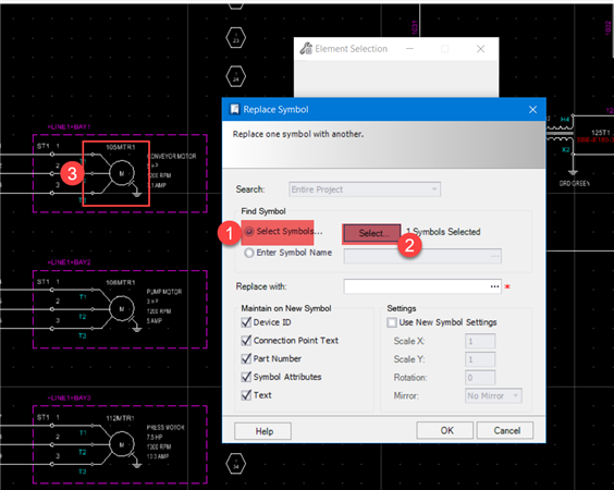

3. If you need to replace a specific Symbol on the page then check Select Symbol >> Select >> select the symbol that needs to be replaced.

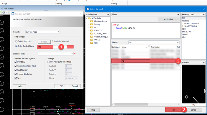

4. Next specify the Symbol that needs to be replaced by entring the name in "Enter Symbol Name".

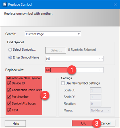

5. Specify the Symbol that will replace the existing symbol "Replace With" specify the symbol settings that need to be maintained.
