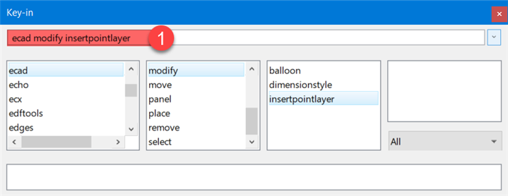

There was a BUG in the earlier version of Promis.e where the level for the Insertion Point of the symbol was not correct. This issue was fixed in Promis.e, but the symbol that is already placed will still not have the Insertion Point on the correct level. This Wiki Article help to assign the correct Level "ECT_DGRM_RFPT_MARK" to the Insertion Point Symbols
Note: This feature is available in Promis.e version after Promis.e CONNECT Update 6 and later versions.

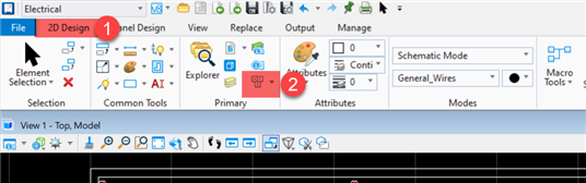

1. Select the Key-In options from the 2D Design >> Key-In under Primary.
2. In the Key-In Dialog key-in "ecad modify insertpointlayer" and select Enter Key.
