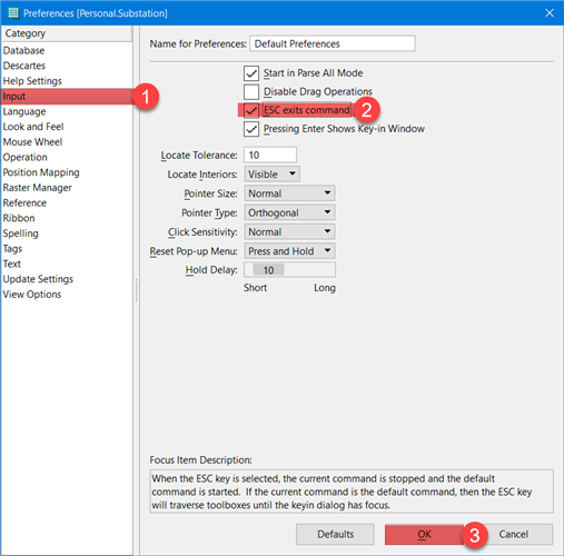

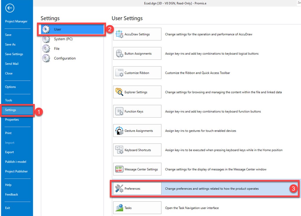

1. In the Project Manager select Settings >> User >> Preference.
2. Next in the Preference dialog select Input >> check the "ESC exit command" option >> Select Ok.
