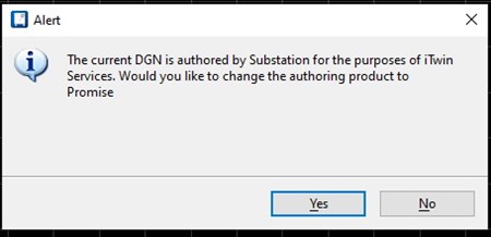

The current DGN is authored by MicroStation for the purposes of iTwin Services. Would you like to change the authoring product to Promise
The current DGN is authored by Substationfor the purposes of iTwin Services. Would you like to change the authoring product to Promise

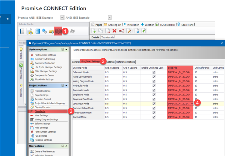

1. Check the Seed file that you are using to create the Project Page for the required mode by selecting File >> Options >> Standards >> Grid Snap settings.

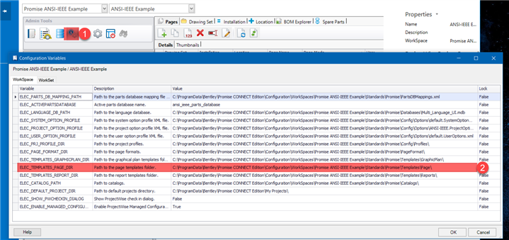

2. The location of these seed files can be found in the Configuration Variables >> ELEC_TEMPLATE_PAGE_DIR

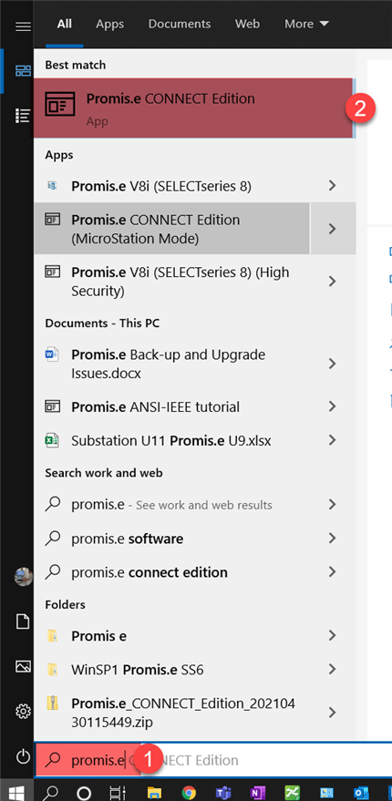

3. Launch Promis.e CONNECT in MicroStation Mode.
4. Now open the seed file that you are using to create the Project page according to details from steps 1 & 2 and when the page is opened and the message pops up select Yes.

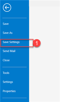

5. Now to save the changes select File >> Save Settings.
