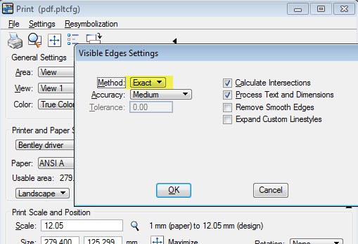

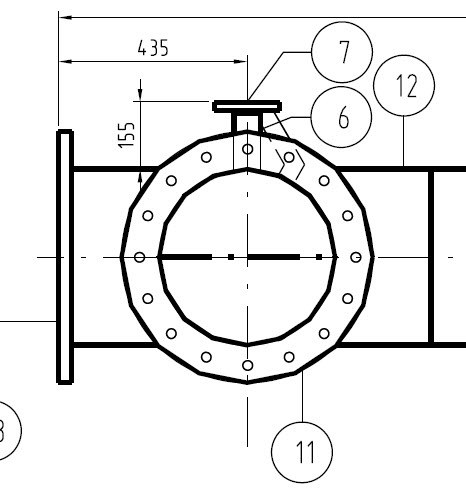

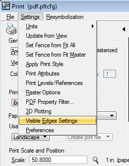

When PDF is printed from sheet model in OpenPlant Modeler, shape of the circle change to polygon. See below snapshots.
Shape in the 2D Sheet Model:
In PDF file:
Steps to Resolve
  1. In the sheet model, Go to File > Print to PDF.
  2. In Print dialog, go to Settings > Visible Edge Settings.
  3. In Visible Edge Settings, change the method from Fast to "Exact" and click OK.

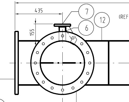

  4. Print the PDF file and verify the result.
