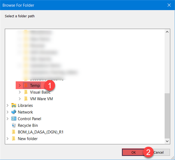

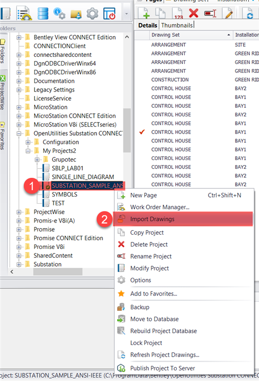

1. Open Substation Project Manager and Right Click on the Projects into which you want to import the DGN file and then browse to the folder where the drawing file DGN is located and select Ok.

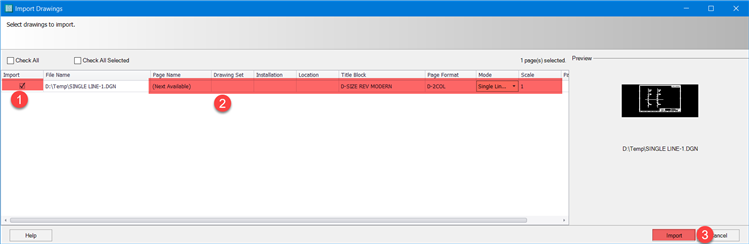

2. Next check the Drawing that needs to be imported and Specifies the Page Number, Drawing Set, Installation, Location, Title Block, Page Format,  Mode, and then select the Import.
