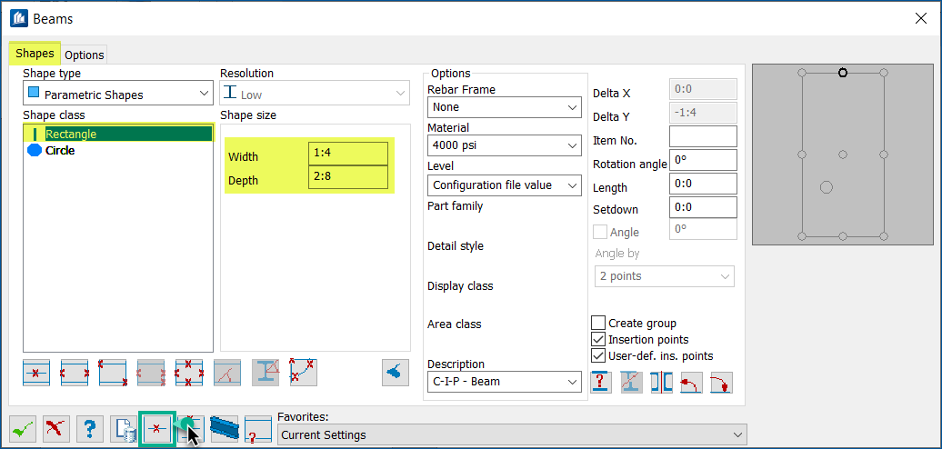

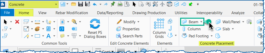

1. Open the Beam dialog located at Concrete workflow > Home > Concrete Placement > Beam.
2. Set your required values for the beam and select  Insert Beam Between Two Main Beams button.

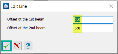

3. Now, select the 1st main beam and then 2nd main beam, the Edit Line dialog appears. Enter the required offset values at 1st and 2nd beam. These offset values will be considered on at which end of the main beam you have selected. In this case, we have selected mains beam at the bottom hence offset will be counted from the bottom.
4. The beam is now inserted at specified offset values from the end of the selected main beams.
