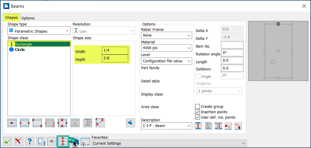

1. Open the Beam dialog located at Concrete workflow > Home > Concrete Placement > Beam.
2. Set your required values for the beam and select  Insert Beams Between Main Beams button.

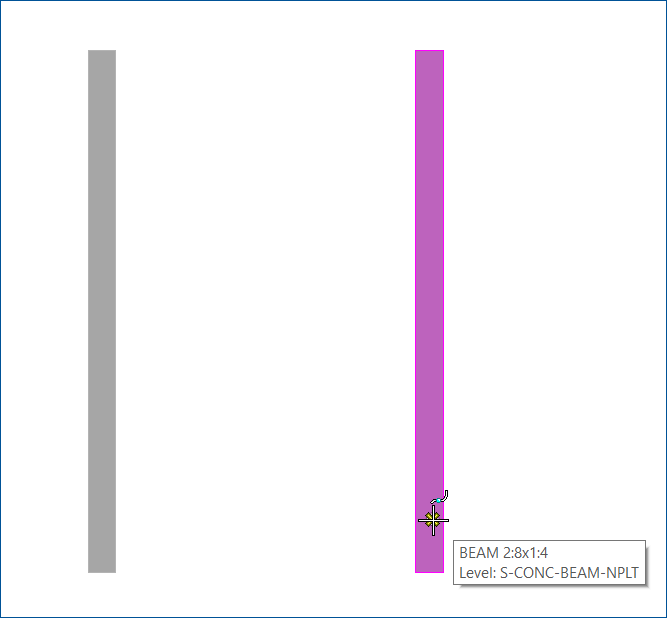

3. Now, select the 1st main beam and then 2nd main beam. In this case, we have selected these beam at the bottom end so that offset will be considered from this end.

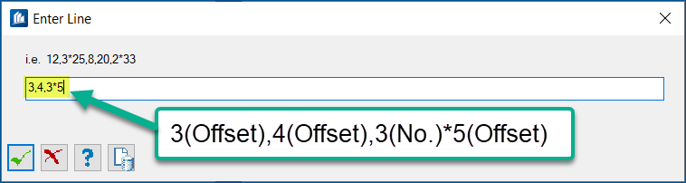

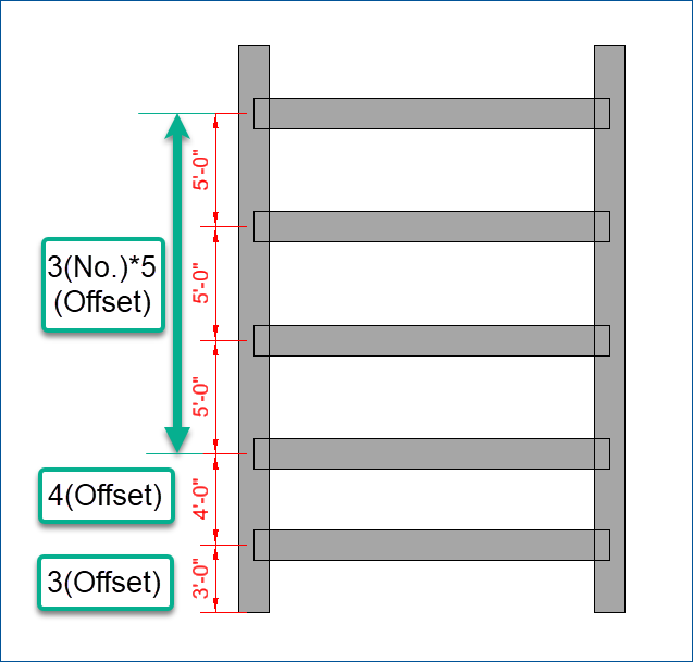

4. The Enter Line dialog appears, enter the required values. For example, 3,4,3*5 this means 3(Offset),4(Offset),3(No.)*5(Offset).
4. Now, the beams are inserted at specified offset values from the end of the selected main beams.
