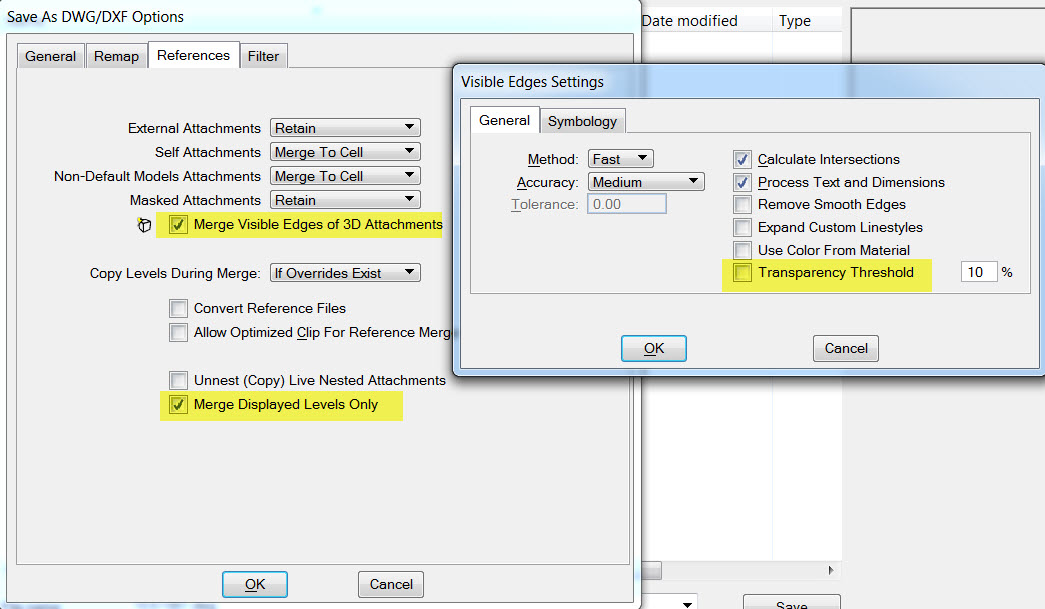

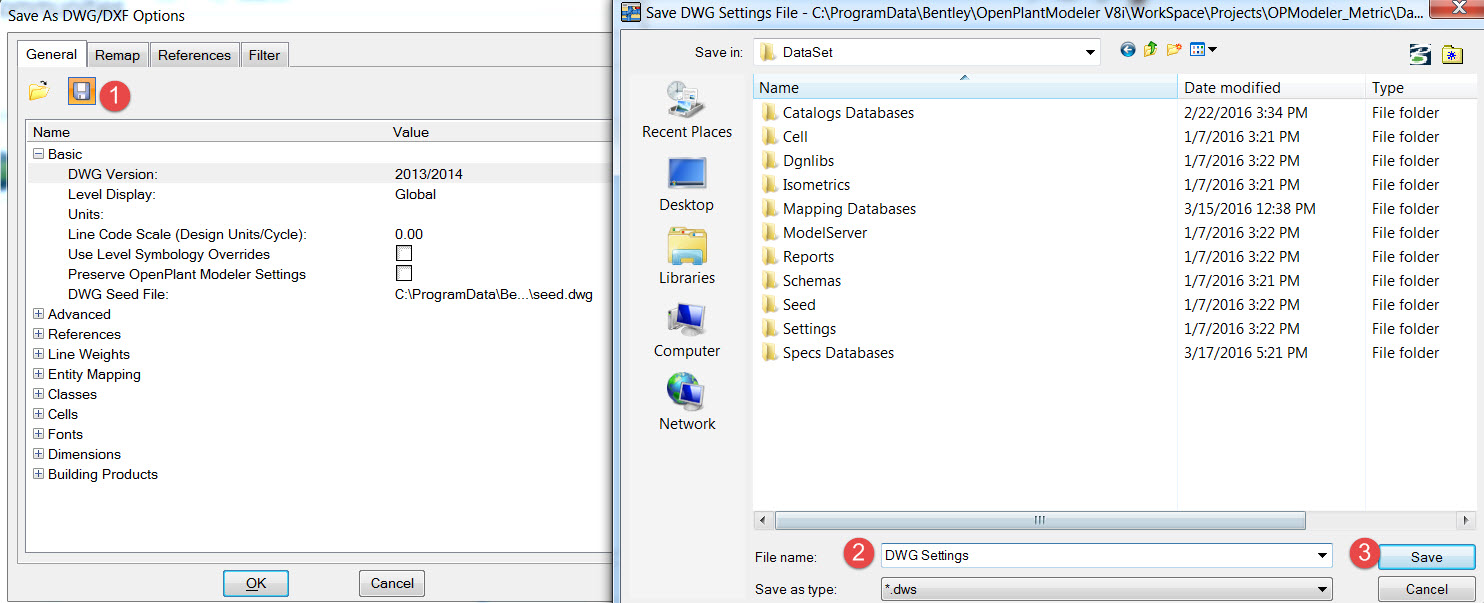

There are several settings as highlighted below which user has to do while exporting the DGN to DWG file. But these settings are lost once the session is closed and user has to perform the same steps again for export. User wanted to save these settings somewhere so that they can save the time while exporting.
  1. Change the settings as per your choice.

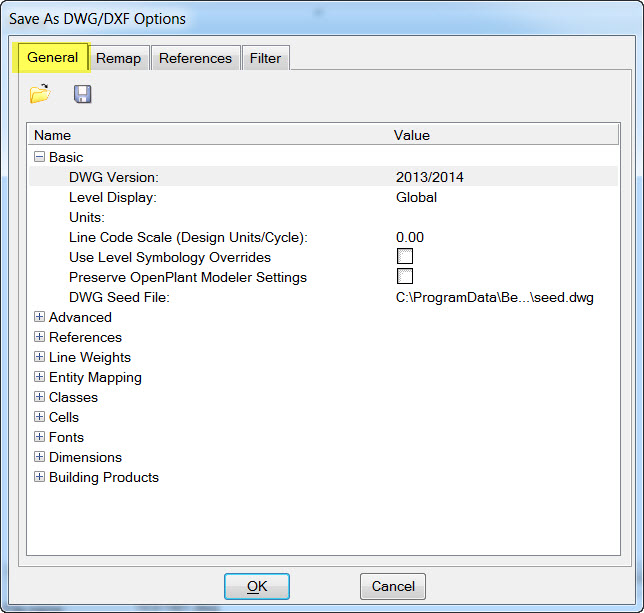

  2. Switch to General tab as shown below.

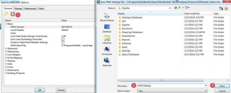

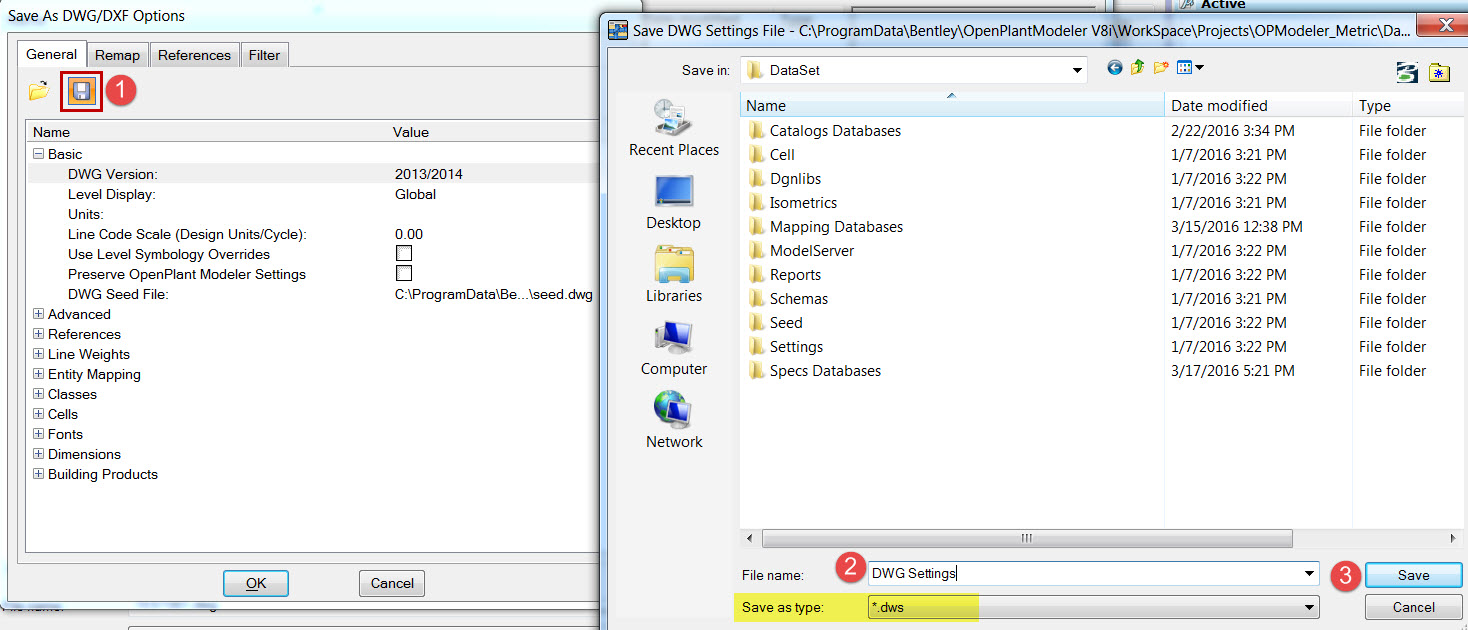

  3. Click the save button and Save the *.dws file anywhere in your machine.

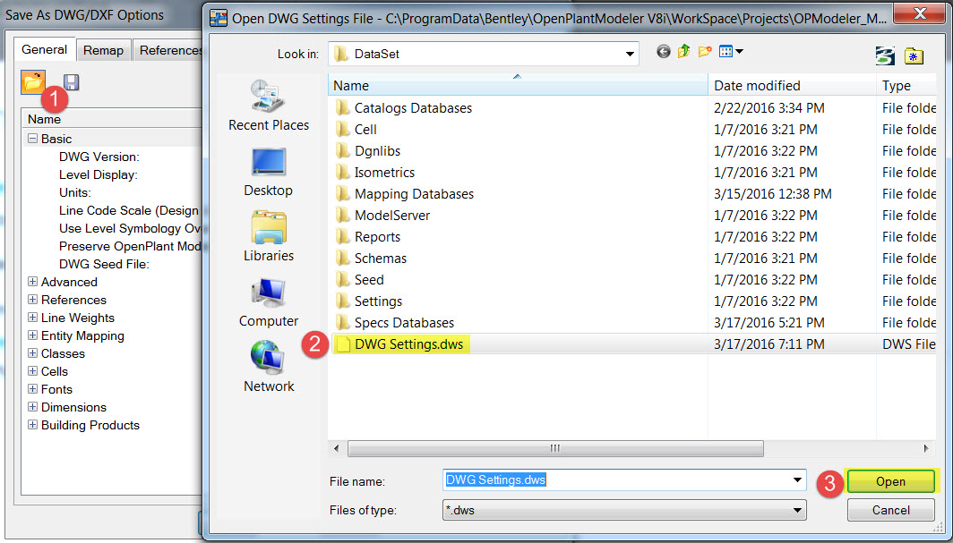

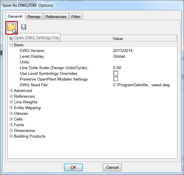

  4. When user has to export the DWG then again open the options dialog and click 'Open DWG Settings File'.
  5. Locate the DWS file which was saved in step 3 and load it.
