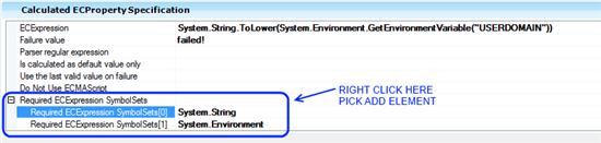

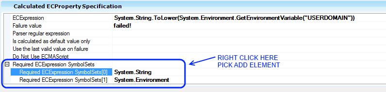

Required ECExpression SymbolSets
When using any of the System functions in the calculated expressions the Required ECExpression SymbolSets needs to be added. Please see the snapshot for additional information on this:
