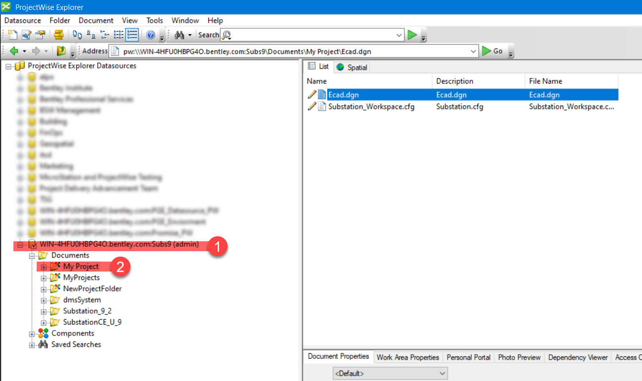

1. Open ProjectWise Explorer and browse to the path location in the Substation datasource where the default project folder has been created.

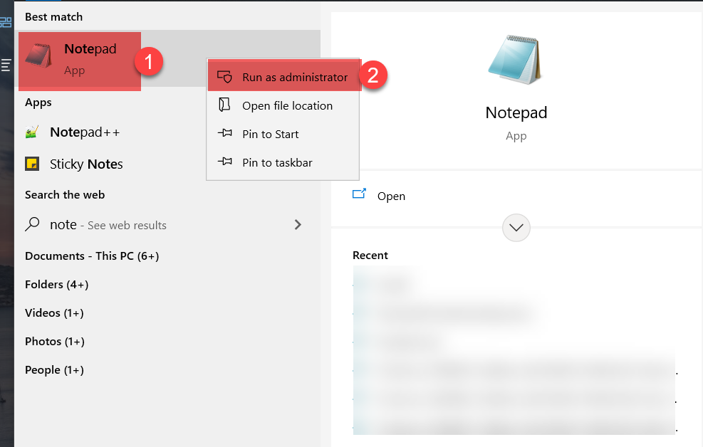

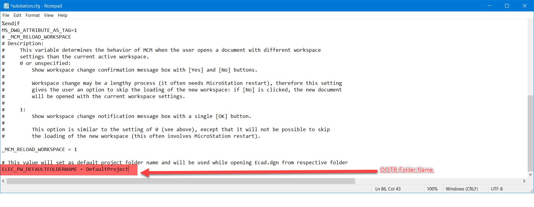

2. Next on the client machine where this issue is being faced. Launched Notepad and select File >> Open browse to the location "C:\Program Files\Bentley\OpenUtilities Substation CONNECT Edition\Substation\config\appl" and open the "Substation.cfg" file in Notepad
Note: Make sure you run Notepad as an Administrator so that the file can be edited and saved.

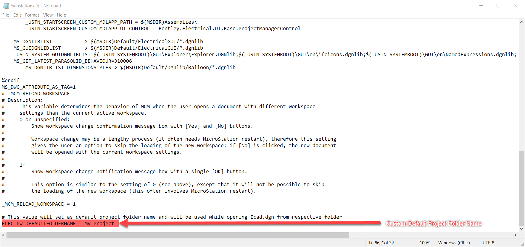

3. Now in the Substation.cfg file go to the last command line in the notepad to variable "ELEC_PW_DEFAULTFOLDERNAME" and check the value matches with the DefaultProject folder name in step 1. Make the changes in the Substation.cfg folder, if you are using a custom folder, like example "MyProject". Else you can rename the Folder in ProjectWise explorer to correctly reflect "DefaultProject" folder name in case the users want to continue using OOTB folder name.
