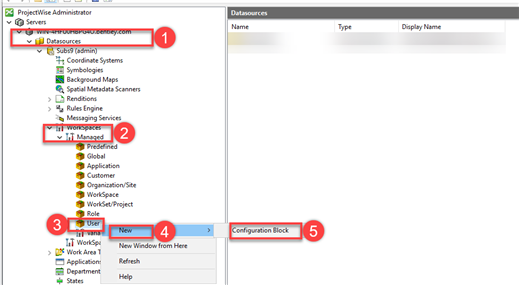

1. In ProjectWise Administrator, expand WorkSpaces > Managed then Right-click the User level and select New > Configuration Block.

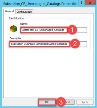

2. In the New CSB dialog specify the Name of the of the CSB "Substation_CE_Unmanaged_Catalogs" and specify any Descriptions and select Apply.

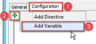

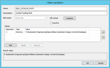

3. Now click Configuration tab, click "+" and select Add Variable.

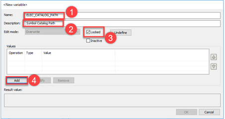

4. In the New Variable Dialog specify Name as "ELEC_CATALOG_PATH", specify the description. check the Locked checkbox and click Add.

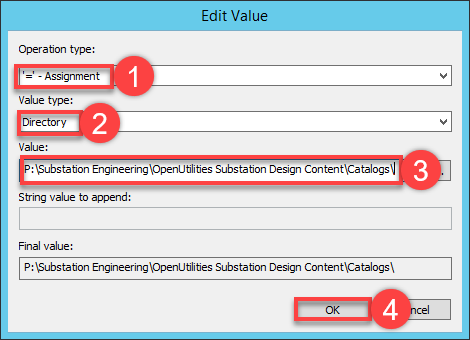

5. In the Edit Value dialog set the Operator Type as "=" - Assignment >> select the Value Type as Directory and set the Value to path of / Location of the Catalog Folder and click Ok.

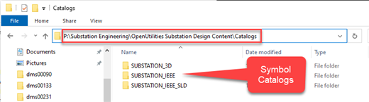

Value for below example: P:\Substation Engineering\OpenUtilities Substation Design Content\Catalogs\
6. Click Ok on New Variable dialog.

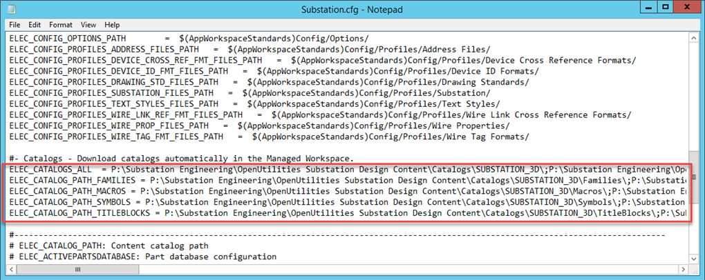

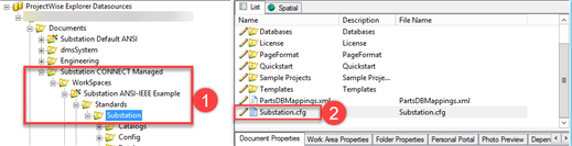

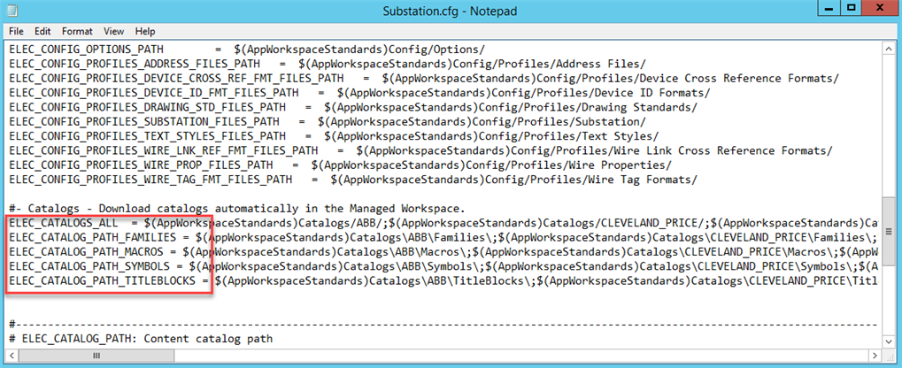

9. To Set the Catalog Download variables browse using ProjectWise Explorer and locate the Substation.cfg file in the WorkSpace and open using Note Pad.
10. In the Note Pad browse to the section with the variables ELEC_CATALOGS_ALL, ELEC_CATALOG_PATH_FAMILIES, ELEC_CATALOG_PATH_MACROS, ELEC_CATALOG_PATH_SYMBOLS, and ELEC_CATALOG_PATH_SYMBOLS and modify the existing variables to redirect to the network location as per details in Step 5.
