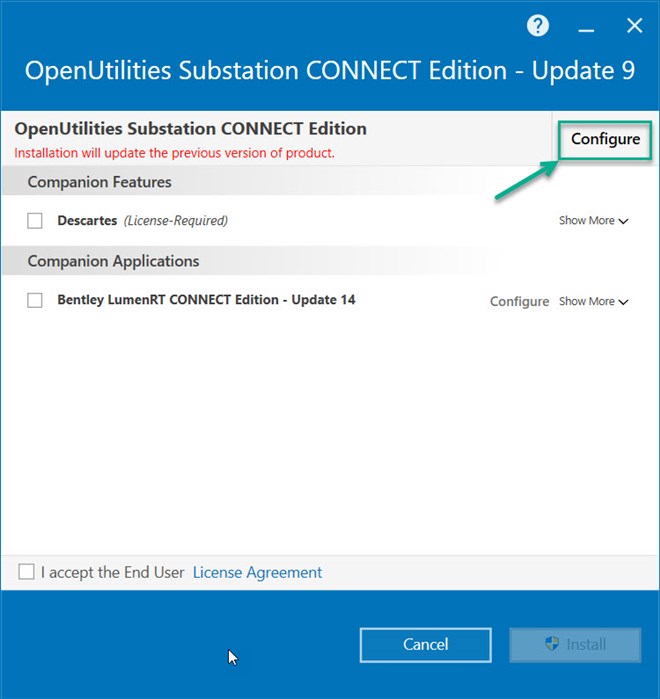

  1. To Install Substation double click on subs100900010en.exe
  2. Click Configure

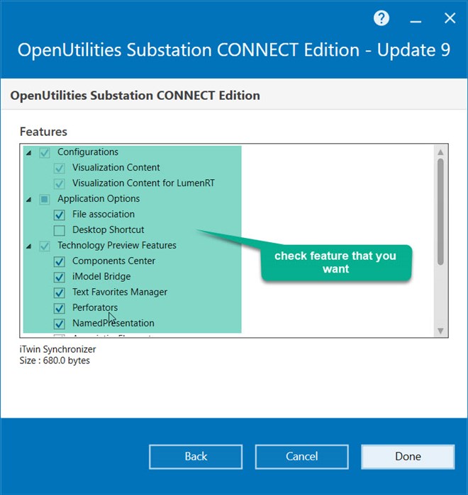

  3. Browse Application Path, by default it will save in C drive (Refer below image). Click Next

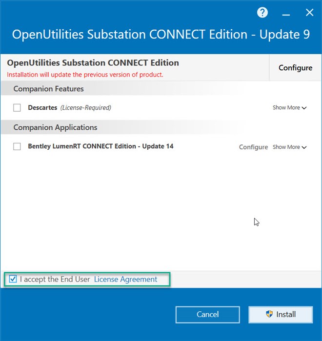

  4. Select feature. If want Desktop Shortcut, then check that box.
  5. Enable ‘I accept the END User’. Click Install.

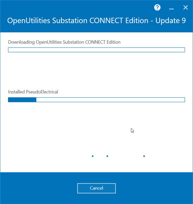

  6. Following Window Pop-ups
  7. Click Finish.
