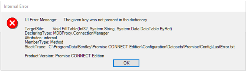

Error: The given key was not present in the dictionary

Error or Warning Messages
When Promis.e CONNECT is launched the following error messages occur pops up.

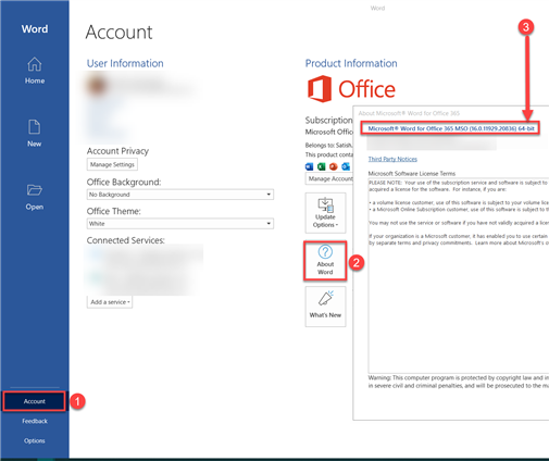

How to Check if MS Office is 32bit / 64 bit
1. Launch any MS Office Application like Word / Excel /  Power Point, then click on Account >> About e.g. Word. See below image for reference.

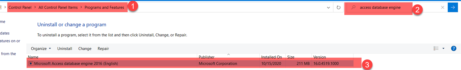

How to Check for Multiple Access Database Engine
1. Go to Control Panel >> Programs and Features and search for Access Database Engine in Search.
