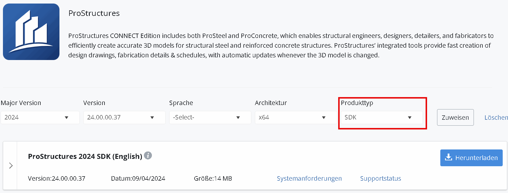

You need to download the ProStructures SDK from here:
Software Downloads

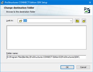

After executing the prostructuressdk10xxxxxxen.msi by double-clicking you will be asked for your preferred folder to install the SDK Content:
