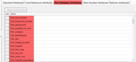

This Text Attribute is used to display values of various fields in the Parts Database for the Part Number that will be associated to the Symbol when being inserted. The value for the Text Attribute can only be modified from the Parts Database Manager. This value can also be populated in Reports.

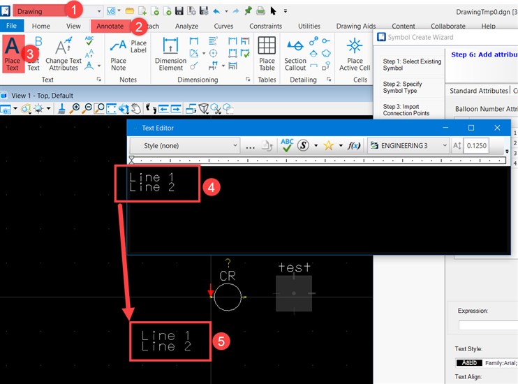

This is a Power Platform tool that can be used to Place Plain non intelligent text in the symbol. Also the Text can be placed in multiple Lines. The text will always be visible in the symbol and cannot be made hidden like the Attribute Text. The users can easily modify the text by double clicking on text or by using Edit Text command on the Text. It can be used for thing like for example describing the the symbol or as a text which is part of Symbol Graphics. Since this is a non intelligent text it cannot be populated in the Reports.
