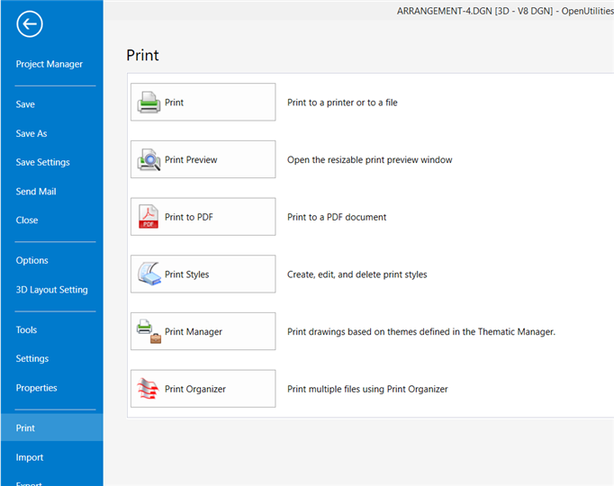

1. Launch OpenUtilities Substation (OUS) and in Project Manager Click Print >> Print Organizer.

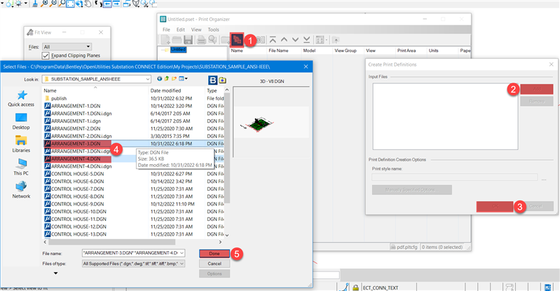

2. Click on Add Files to Set and click on Add in Create Print Definition dialog. Browse to the location of the Project Pages and select multiple DGNs by using Ctrl key and click on Done and OK.

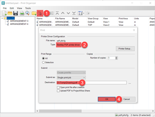

3. Click on Print >> Select the Bentley PDF Printer Driver. Specify the path for Destination of PDF and click OK.
