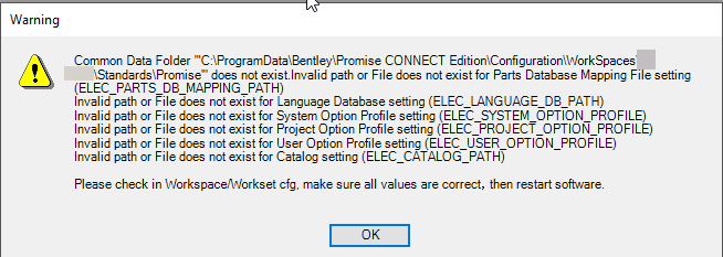

Common Data Folder Warning Message when Launching Promis.e CONNECT
 Product(s):Promis.e CONNECT Edition
 Version(s): 10.00.XX.XX to 10.10.XX.XX
 Environment: NA
 Area: Installation_Configuration
 Subarea: WorkSpace & WorkSet
Background:
The user is getting the below Warning Message when launching the Promis.e Application. There are multiple reasons due to which this issue may occur. In this article are listed the most frequent issues that result in the below Error Message
Reasons for the issue and how to fix the issues
1. Renaming or changing the folder/ file name in the WorkSpace .

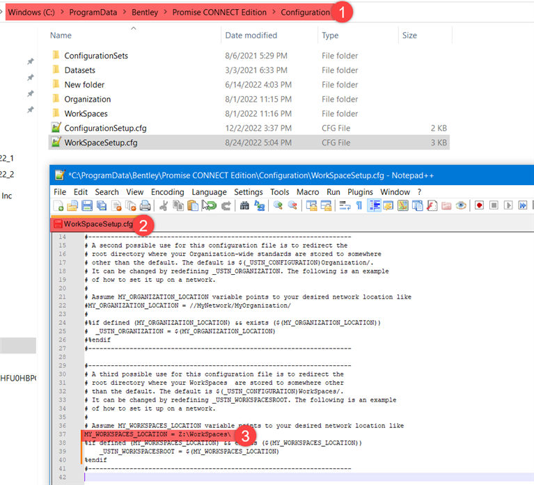

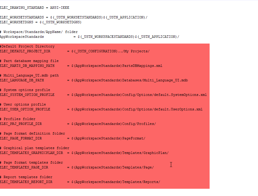

a. Open the Promise.cfg located in WorkSpace folder for OOTB WorkSpace the file is located in the location "C:\ProgramData\Bentley\Promise CONNECT Edition\Configuration\WorkSpaces\Promise ANSI-IEEE Example\Standards\Promise" and open the file in Notepad / Notepad ++. If the WorkSpace is located on Network location skip to next step else skip to Step C.
b. If the WorkSpace is located in the network location browse to the "WorkSpaceSetup.cfg" file located in "C:\ProgramData\Bentley\Promise CONNECT Edition\Configuration" and open it in Notepad / Notepad ++. The check the network location where the WorkSpace is located. Now in network location browse to the Promis.e.cfg file.
c. Now check if the file name and the path is actually present in the WorkSpace folder where the Promise. cfg is located for each variables like Parts Database MDB file or Multi_Language_UI.mdb file or the Templates ........ If there is any difference then the Promise.cfg should be updated accordingly for the new location or else the folder / file name should be renamed back to original details which ever applied according to the user requirement.
