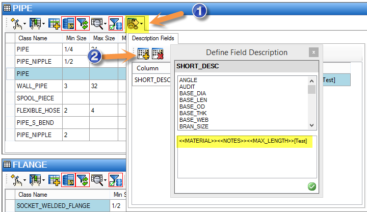

In Specification Generator, to Add Custom description in a field to Populate in OpenPlant Modeler
With the use of Specification generator, in a particular section user tried to add specific text under a field and wanted to get it mapped in OpenPlant Modeler property. Below steps resolve the matter by adding it correctly in OpenPlant Specification Generator.
