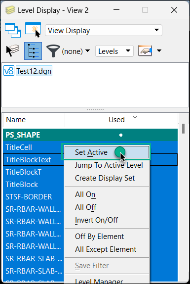

1. In the Level Display dialog, right click on any other level (other than active level) and click on Set Active option.

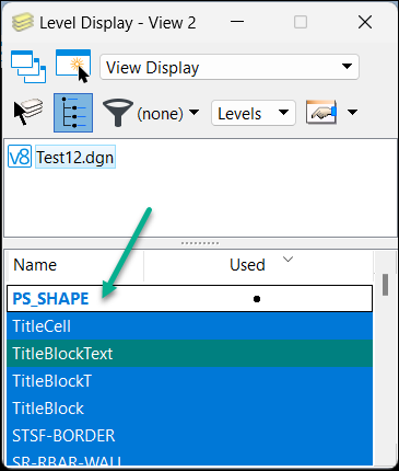

2. Now, you can turn off the previous active level by left clicking on it.
In this way, one can turn off the active level from the Level Display dialog.
